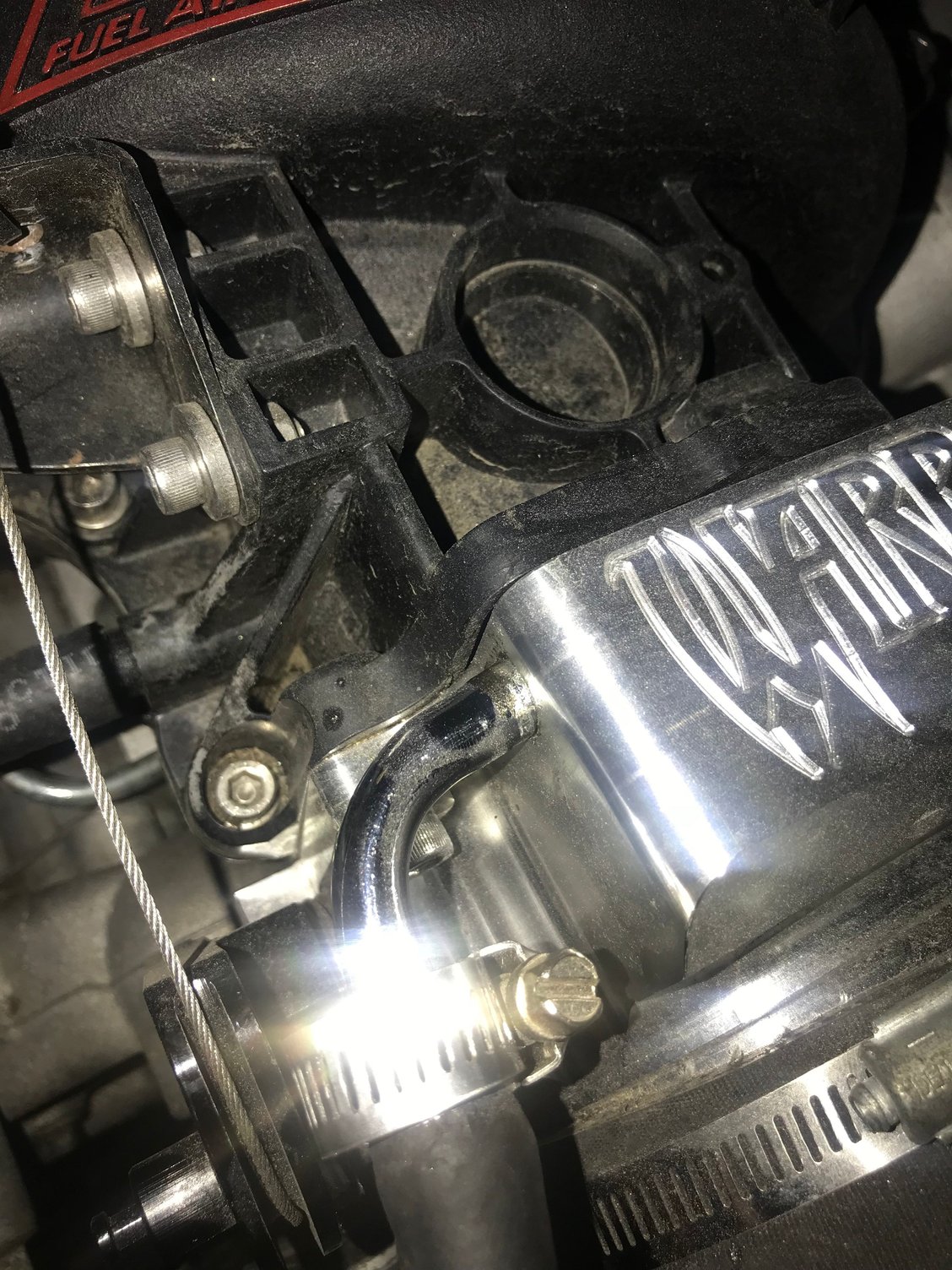

Well, although nobody answered, I might have found the culprit. It turns out that the fresh air vent from the 92mm Warr TB was loose and causing a vacuum leak this affecting the idle and triggering the code for the IAC. I believe this in turn caused P0300.
LTFT (Long Term Fuel Trim) and STFT (Short Term Fuel Trim) where trying to compensate for the rich and lean conditions caused by the erratic idle.
I took off the elbow and tapped for a 1/4” NPT barbed fitting. While I was there I went ahead and re-did all my PCV hoses.
Drove it for over 40 minutes and seems like it has been taken care of. Idle is way better and under 950RPM
