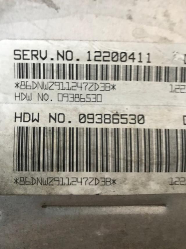

Old May 13, 2018 | 09:56 PM
All Pontiac WS6's Avatar
iTrader: (9)
Joined: Feb 2014
Posts: 188
From: Lawrenceville, Ga
Default Ecu
Is this what I need?
Old May 14, 2018 | 11:48 AM
LSX Power Tuning's Avatar
FormerVendor
Joined: Mar 2013
Posts: 2,367
Likes: 26
From: Brenham TX
yes that will work
