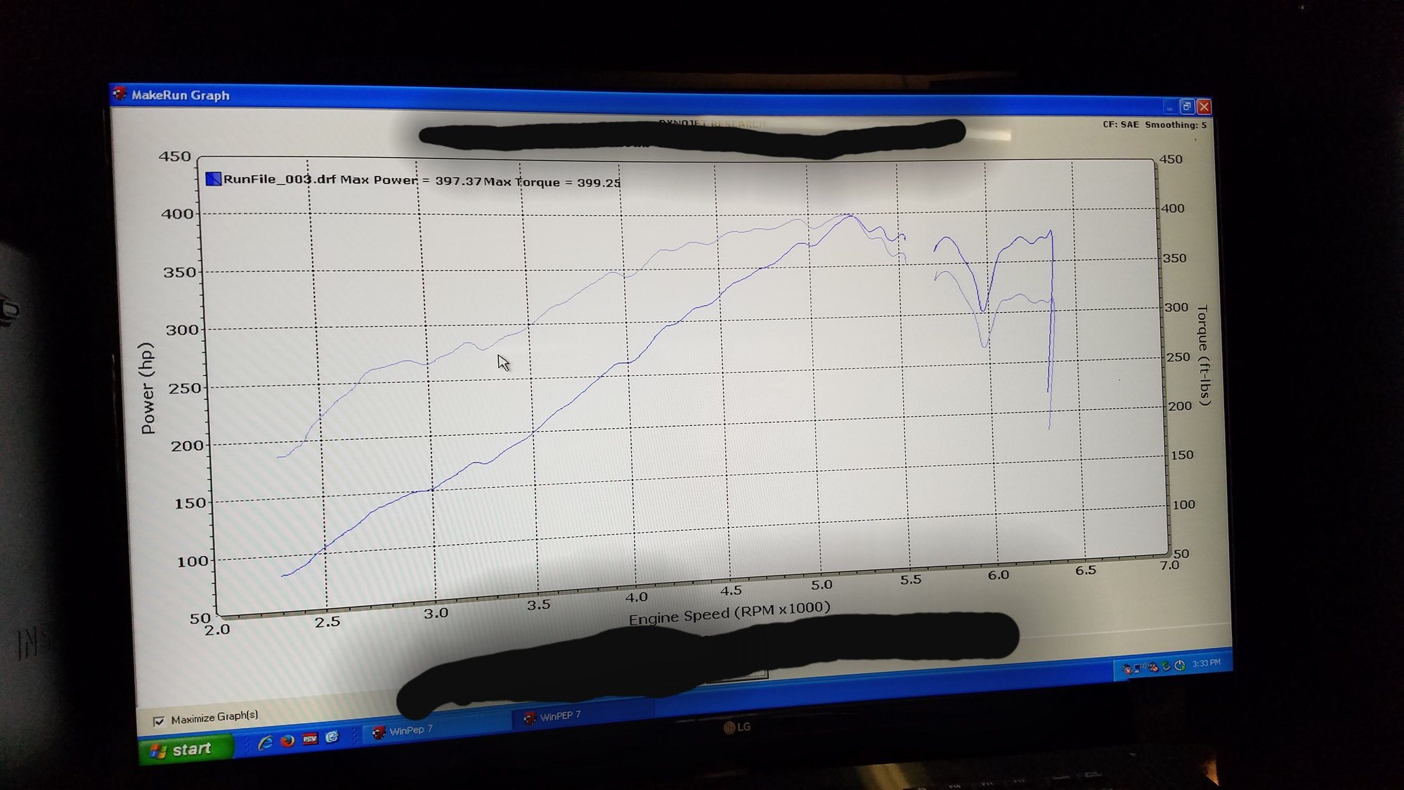

What else is a sign of valve float? I thought once it floats it won't recover? Also the guy at the tuning school on youtube said it would show in the rpms tuning school video talking about valve float with hptuners
Your graph looks like valve float, also having the exhaust change it's sound as a tell tale as well as it not accelerating as fast through the RPM range up top as it did in the lower RPMs. I don't care what the tuning school says it's not always true.
Not doubting you at all. You and all the others are getting me to research a lot of things and that is one that I came across. I will take the valve covers off and check things out on Sunday as tomorrow I will be out for most of the day coaching youth football. Quick question though will valve float just happen in drive/gear or can it also happen during revving? This will let me know if I should turn the car on and record the valvetrain and rev it up.

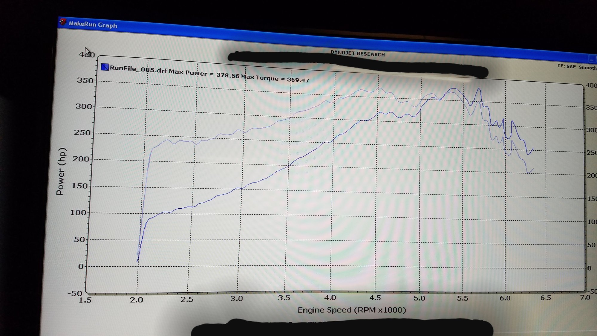

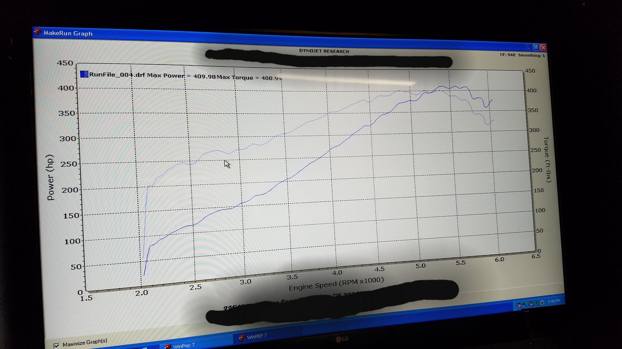

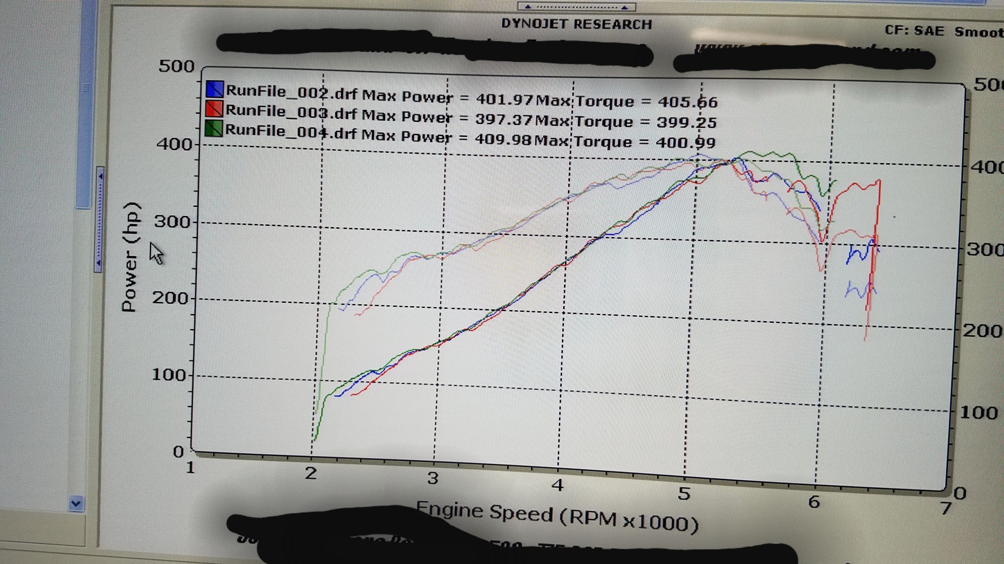

Okay so I managed to get some graphs of the last runs before I made this thread. I am obviously using hydraulic lifters and have read that with valve float it would run terrible after it floats because of the lifters get stuck in a sense would making back to back runs without giving them time to rebound be possible without any changes from before it floated? Also ran it in first gear all the way up to redline without any issues and it pulled all the way through with no hesitation or stubble. Next I will try recording it and making a pull in boost to see if I notice anything. The 409.98hp graph was the last one he did after he played with the tune to smooth it out. He just put the 450 tune back in because he couldn't figure it out. Could the problem with the tune and running lean cause some issues? He doesn't use his innovate and goes off my wideband but I have been reading also that my wideband might be in a bad position as it is before the turbo and not after so I might be off a couple of points if what I read is true.
combined
first one I think
second one
final one of that day
