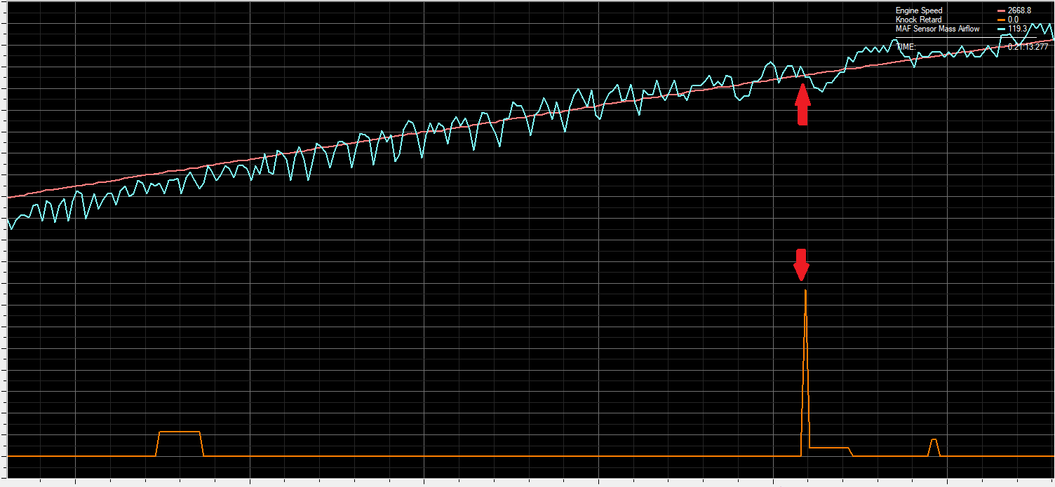

Yes, the picture is above. I notated the dip in the MAF reading (blue'ish line) with a red arrow, and the corresponding knock (orange line).

Here's another image from a recent log file showing what I am describing. Blue'ish line is MAF, pink/rose colored line is RPM, orange is knock.
Where I've pointed out each time with the red arrows, it seems when there's a pronounced/extended dip in the MAF reading, that's when a split second later I pick up some knock, but then when the MAF reading recovers, the knock goes away. Seems, at least to me, to be a pattern.
Perhaps this is normal MAF behavior, but if not maybe that's the cause of my high rpm WOT knock. The MAF is having these dips in readings, which for a moment tells the ECM less air is coming into the engine, it pulls just a little fuel resulting in the knock, then when the MAF recovers, fuel comes back, knock goes away. My WOT AFR's are good, maybe even just a smidge on the rich side.

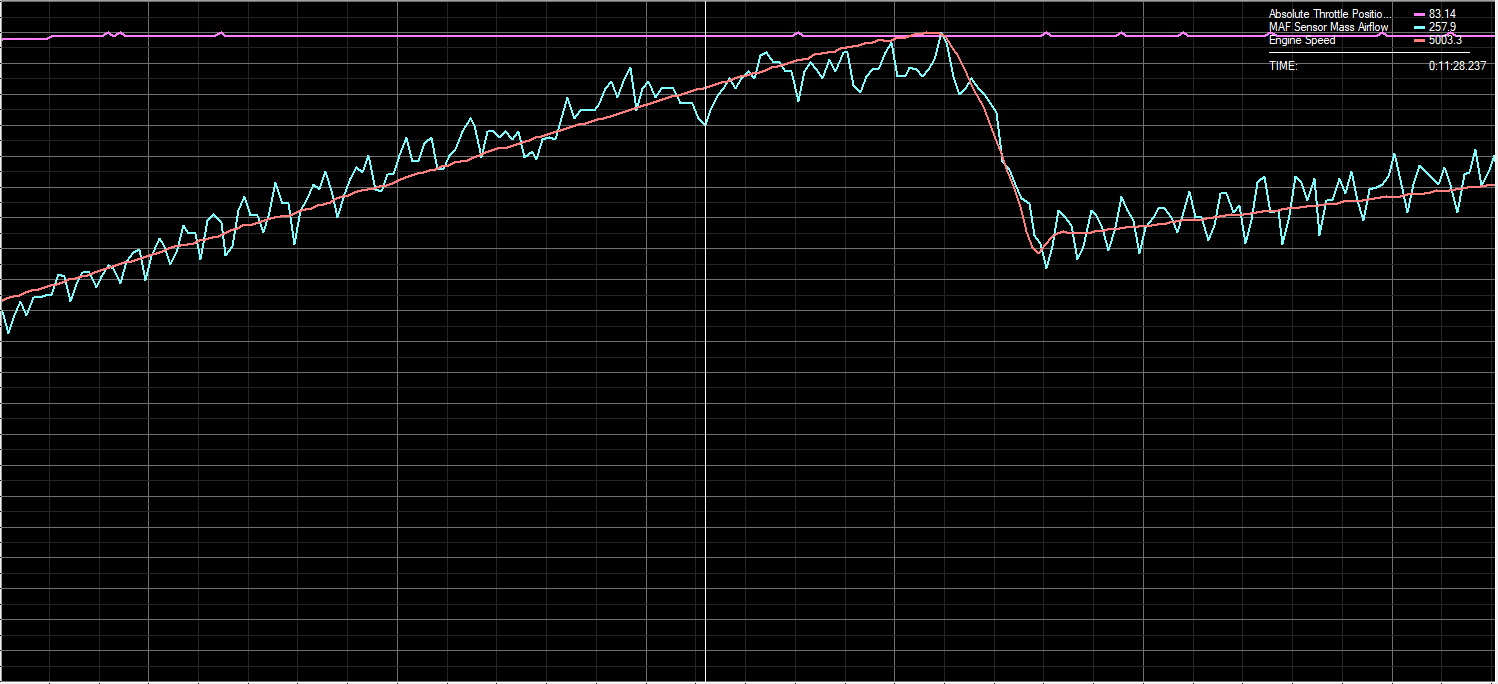

Well, this is at WOT, so I'd assume the TPS is staying maxed.
Absolute Throttle Position is pegged the hole way in this log, MAF reading fluctuations still present. The RPM & MAF drop is a gear shift as you'll notice the throttle position remains wide open.

I wonder if its just the resolution and filtering of the Diablo software. Be interesting to log it with hpt or efilive.
