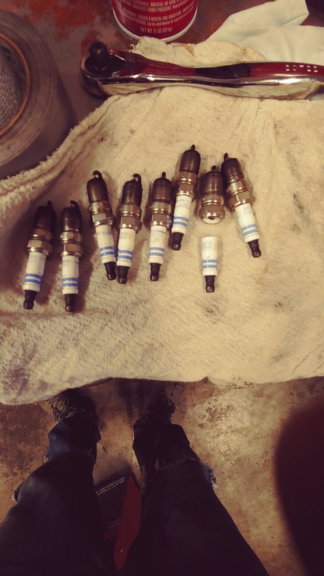

As the title states i took my car to a tuning shop with dyno. They are ready to tune for w.o.t. and they start seeing the power drop around 5k rpm so they shut the car off "check" everything and try again.
Well the engine accumulated a knock. So i trailer it back home and find cyl. 1 spark plug snapped in 2, the wire with the metal sleeve and spring was still stuck to the other half of the plug (enough to probaly missfire or weak spark?) However the knock is also coming from the same cylinder...
Could this have maybe caused pre det. And or in any way caused this knock?
I did replace all 8 plugs and double checked to see if it fixed the problem.. nope. Still a knock on #1 only.
I dont wanna get into detail but the shop i brought it to seemed very VERY unprofessional the whole way through the process, i wonder if they sabotaged me or are just acting like they dont know wtf happened so they dont have to pay or fix it, i just dont know if a plug could do that, but since they were putting it to the limits on a dyno....

From the pic you’ve posted, it looks as though the plug was firing for some time. Show another closeup pic of the electrode side of the broken plug. Prolly just a coincidence that this transpired when it did. Might of even saved you a hole in the block, if in fact you have a bearing problem. I’d pull the valve covers off to make sure you’ve not got an issue upstairs that maybe your confusing with a knock, which is two different sounds.

When you state engine knock, are you talking about a knock that the sensors pick up or are you talking about a mechanical knock that can be heard like a rocker or something?

I had a misfire on cylinder 4 on my Silverado. I replaced the wire and plug. A couple months later, I was misfiring on the same cylinder. I took it to my regular mechanic. He found that the electrode ceramic was cracked in half. Probably a bad plug from the factory. No problems since then. Stuff happens at times.
