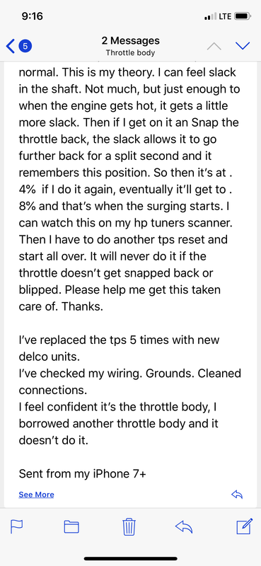

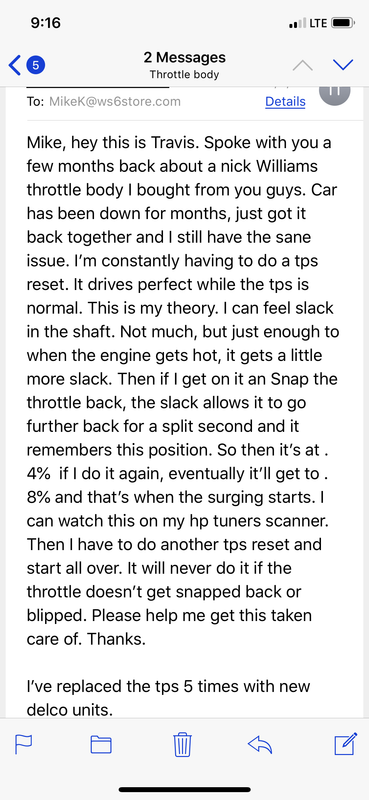

Did NW offer to fix it free of charge? It should be taken care of due to manufacturing defects. It was never ws6store problem they are just a dealer.

Yea he did. He wrapped a piece of electrical tape on the shaft and sent it back to me like that. You think I was happy about that? Would you?

Yea. I didn’t really want to post that. But that’s the god honest truth. I was not happy at all.
