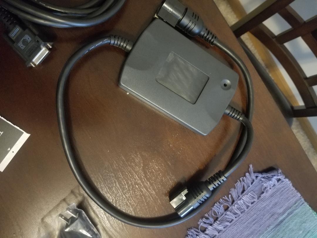

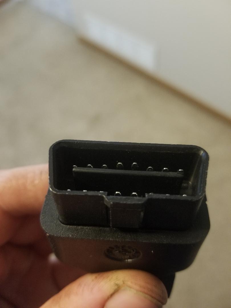

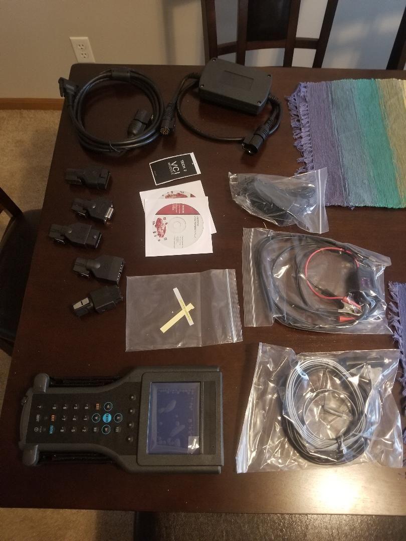

The package shipped from Hong Kong on Wednesday and arrived at my door today, Friday. Amazing! Shipping was free. Everything appears to be as advertised, except I didn't receive all of the stickers. Not a huge deal. I will hook this thing up to my Sonoma and report back with details on the functionality. Here are a few pics I snapped with my phone. The OBD2 reader has 2 pins on the top middle row that stick out a hair further than the others. I saw a youtube video of a guy who noticed the same thing, although he said it worked fine.

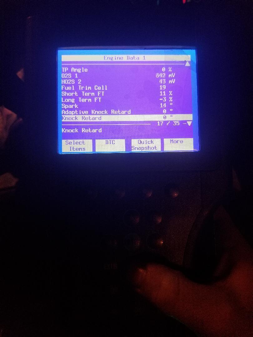

Here is some engine data from my 2.2L beast. I started the engine and watched everything live. I also recorded some "snapshot" data and re-watched it. Pretty cool. I know most modern scanners can also do this.

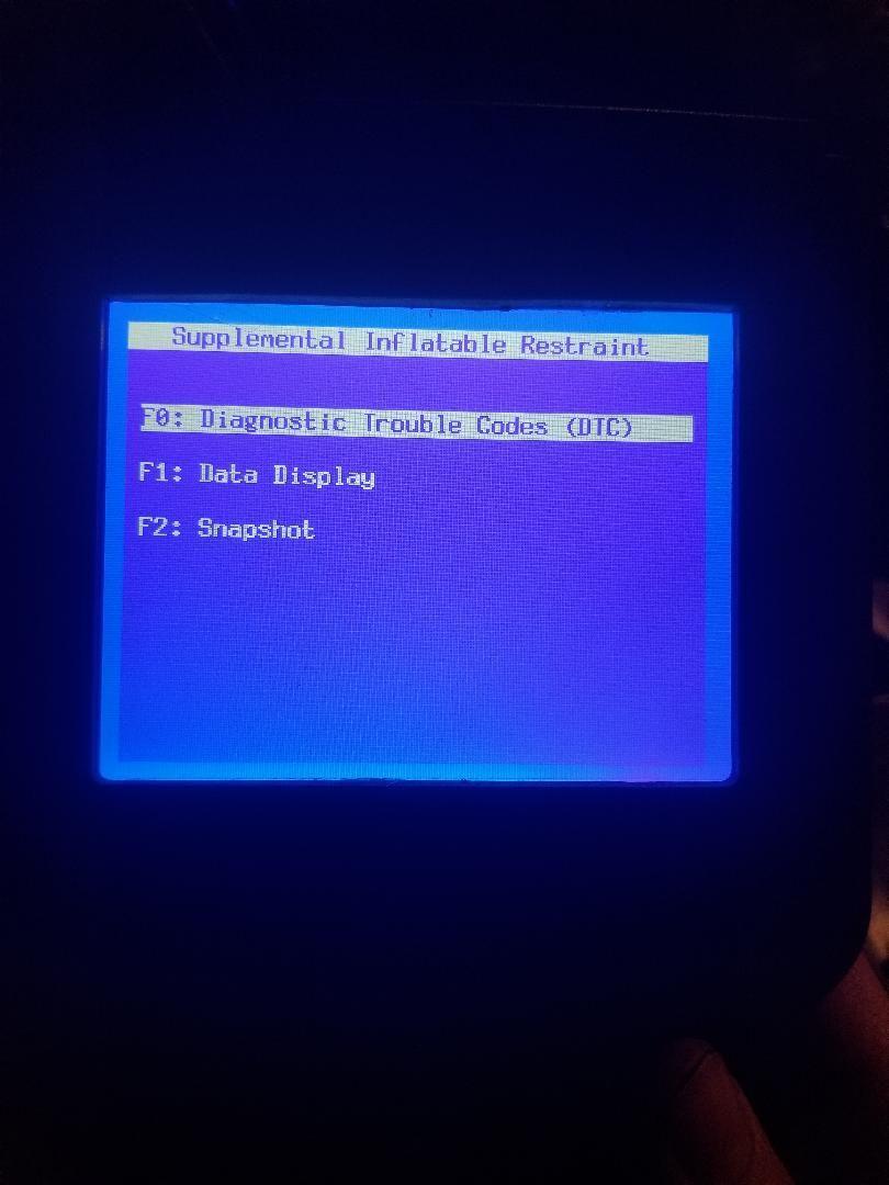

Checking for Air Bag codes/communications. I did not have any DTCs. It is nice to know I can pull air bag codes and look at data!

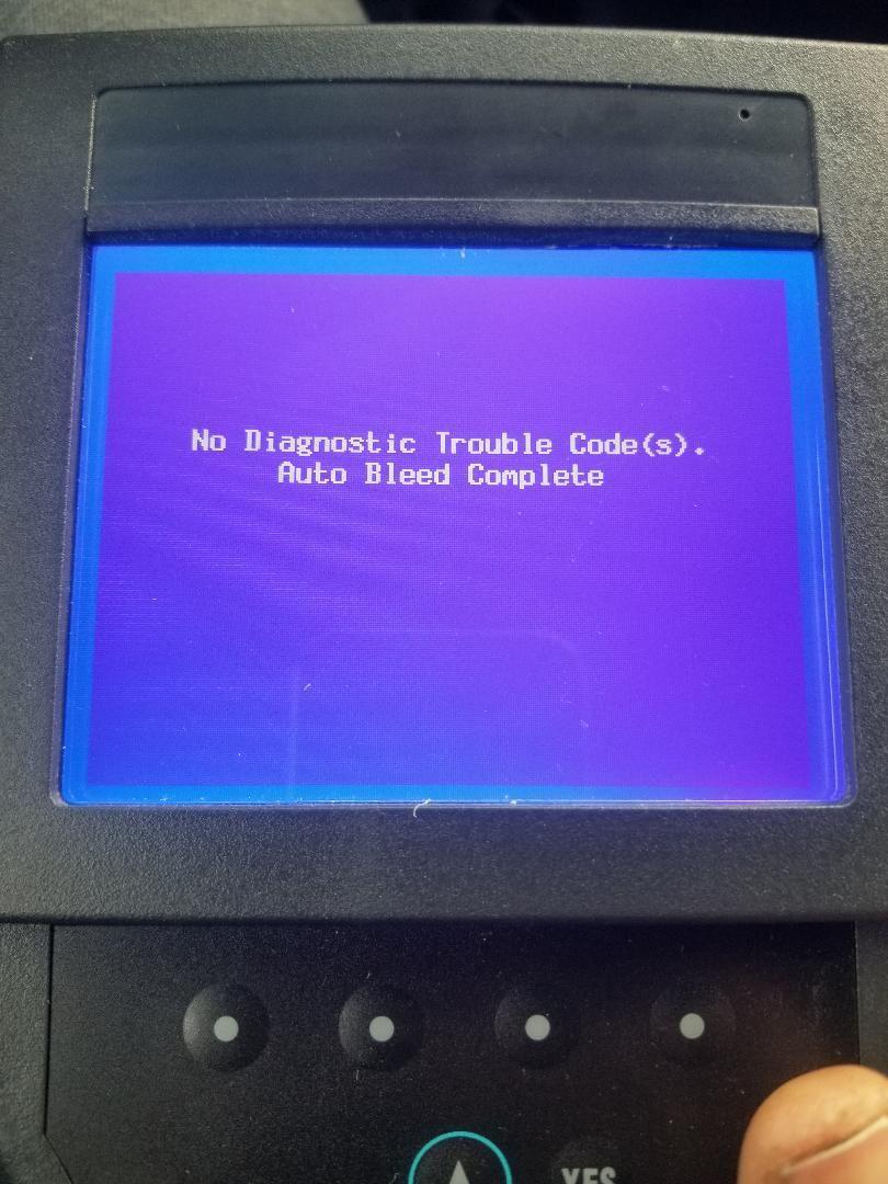

I was able to auto bleed the ABS system. I felt the ABS pump vibrating through the pedal. I have done this at work after replacing rusty brake lines coming out of the ABS pump. Very useful, because it is nearly impossible to get air out of the ABS pump without being able to "auto bleed."
