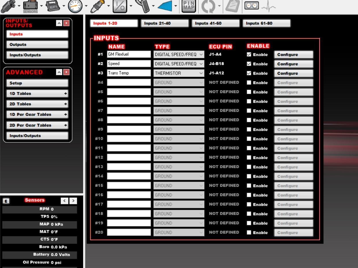

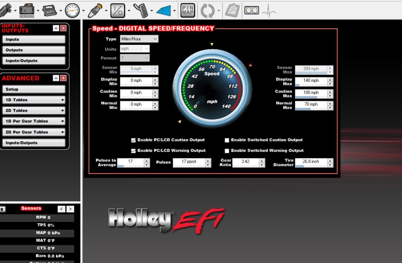

If the speed sensor is the same as the TR6060 it should be fairly easy but will use one input and one output, I'm running a Dominator not the Terminator X but it looks like it's configurable in the X software I have on my computer.
