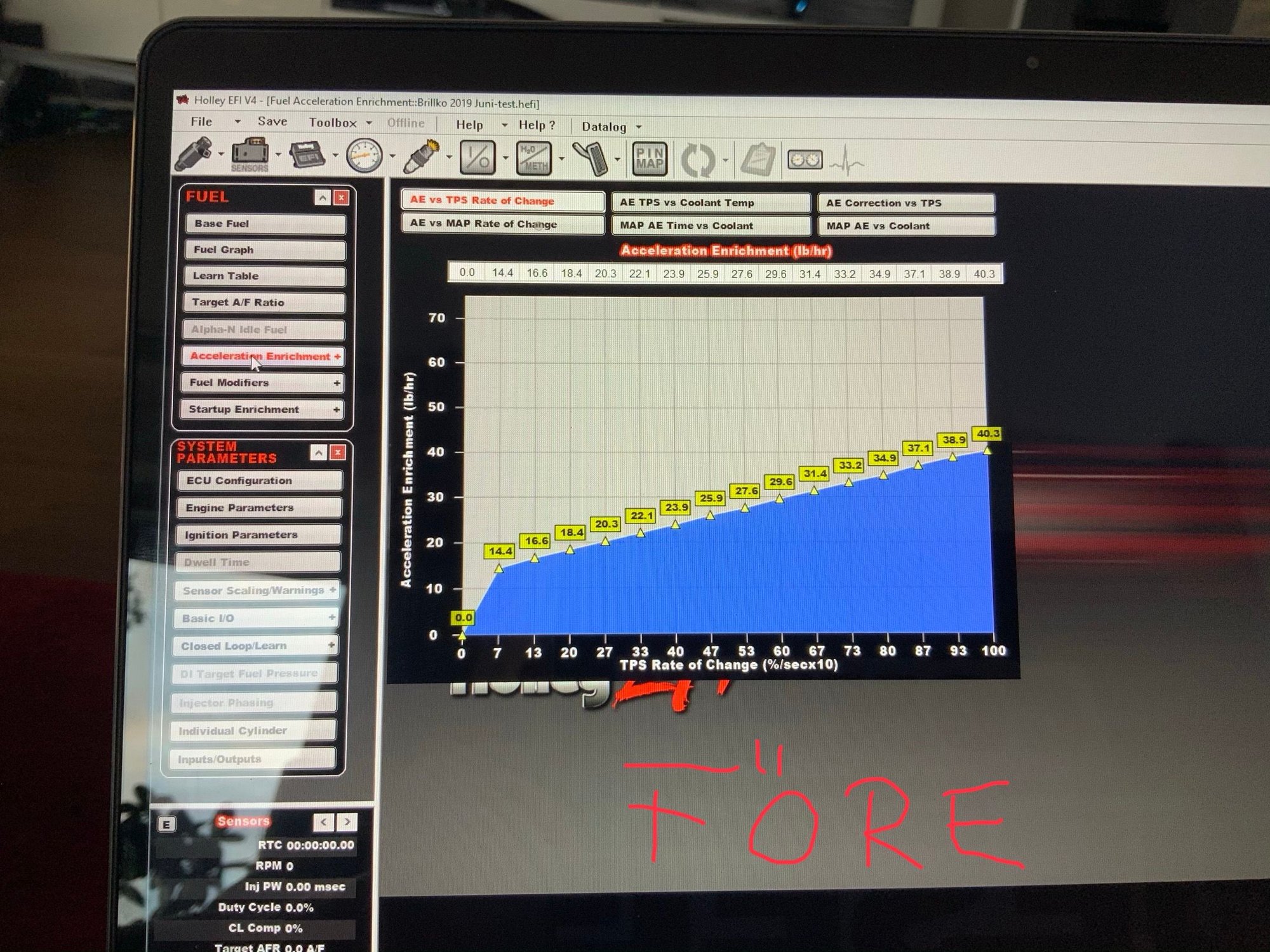

I have a stock LS3 (out of a 2012 Camaro SS), ECU is a Holley Dominator. The engine is ”bogging” quite a lot even at operating temperature. So, how much is a reasonable increase of the AE? This is what’s set as of now. I would apreciate any hints from anyone with Holley ECU experience.
Thanks a lot.
