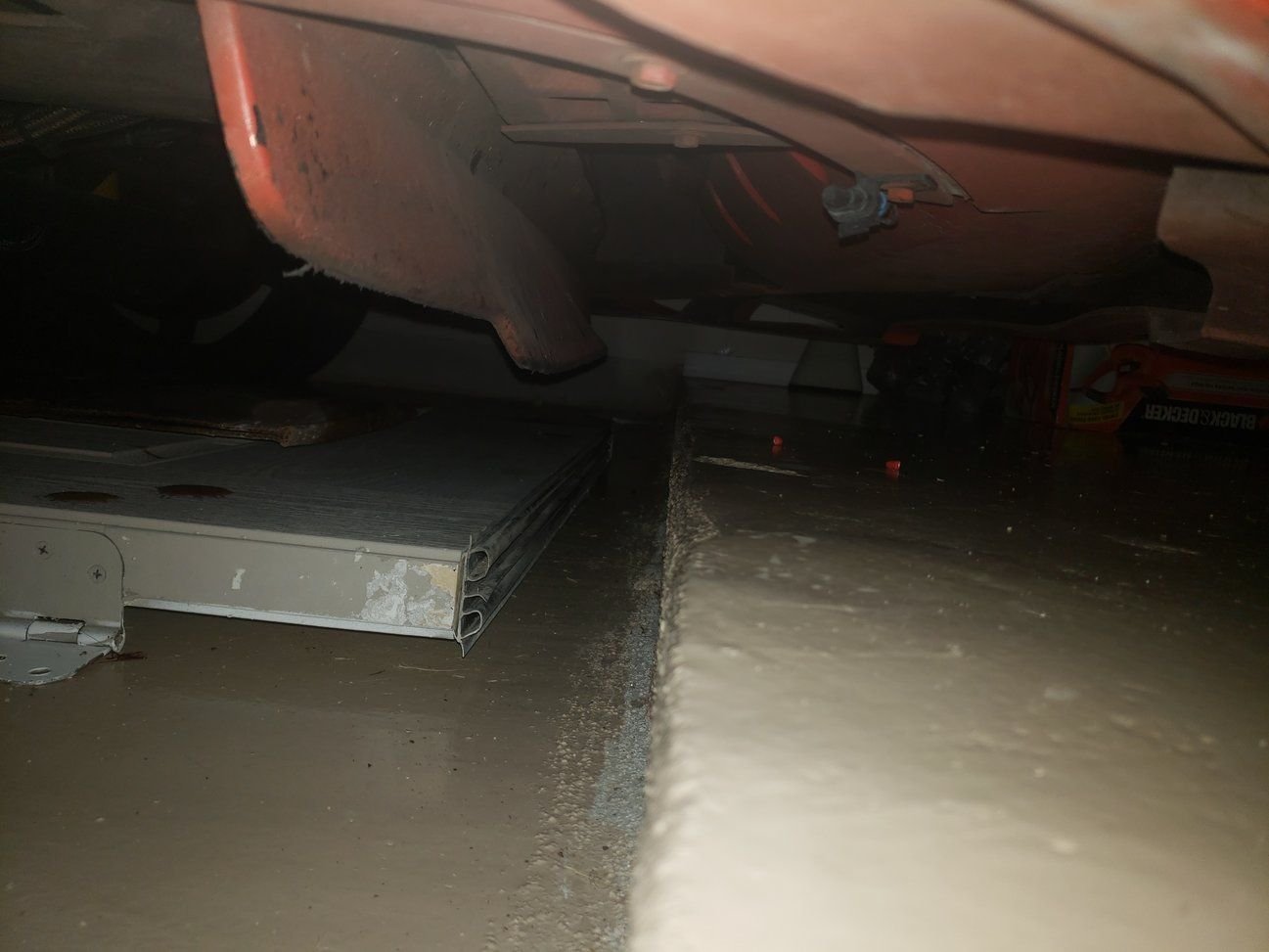

Welp, system was bled by a machine and all the air was taken out. The water pump was also replaced but unfortunately its still overheating. Given this was also happening on the old motor, we're suspecting an airflow problem of some sort. The Air-dam is there and intact but it is beveled in the center:
I'm worried my body kit in some way may be blocking airflow to the air dam but it looks like the air dam is considerably lower than my front valence. I'm going to order a replacement Air Dam anyway. I found a few places that carry them new and even have them in stock which shocked me.
Tomorrow it gets dialed in and tuned with the new fuel pump and MAF. I hope to beable to fix the overheating problem.
If this doesn't fix it, the only thing I can think of is maybe a cracked head. Im not getting smoke out the exhaust or anything abnormal like that though. Would this be something I would notice outside of the motor overheating?

Is your car parked on a door in this pic?

The door is between the the wheels so its not technically 'on' the door, but the door is under it. Story behind that is, I bought a new house in January but my LS1 motor pre LS3 swap had a horrible oil leak, to the point it was nearly gushing. Rear Main seal was replaced twice but the oil pan gasket never was and I didn't feel like going through the hastle knowing I was going to replace the motor anyway. The door in that pic was the old front door that I took down and left the house completely open to the public as to prevent oil from spilling all over my precious garage floor...
...kidding, the previous owner left it there because the front door was replaced to accommodate for a fancier door and I figured it would be the best way to ensure no oil got on the garage floor.
