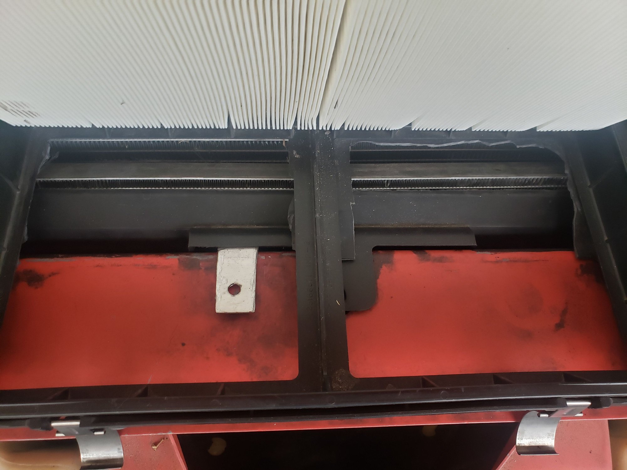

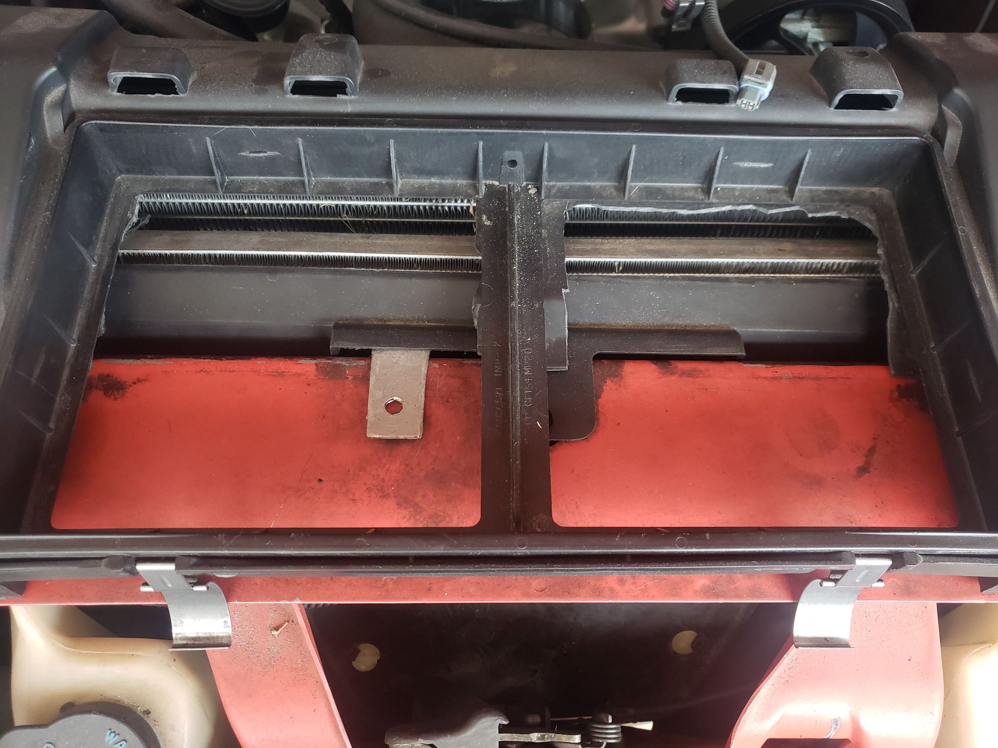

I removed old radiator, going to put the new one in tomorrow. While removing the old one, I could help but wonder about this...
That's where the filter goes in under the LID. It looks like someone tried to do the FRA mod and you see directly to the radiator underneath where the filter would be. Do you think that as I'm driving, I'm pulling in heated air from the radiator thus causing my IAT's to stay high?
I just did the radiator and coolant fans on my 01 a couple of months ago. It wanted to overheat on me due to a large air pocket that was trapped in the system.
just wondering did your car exhibit strange burping procedures? Mine would gush all of its coolant out if I left the cap off to burp it. It would never stop gushing. I would end up having to seal it, drive till the thermostat recycled and the coolant got low, and refill.

Originally Posted by JoshHefnerX
These cars are a real butthole to bleed the air out of the coolant.
From what I understand you're supposed to just remove the radiator cap and then run it for awhile until it burps.
That's taking it too far if you ask me!
Do you think that also may be why its overheating? Air intended for the radiator going into the airbox instead?

I wouldn't think so but I'm thinking it could contribute to higher IAT's

Anytime your sitting still with the engine at idle for any extended period of time the IAT gets up there.
Im going to replace the radiator support, going to order it tomorrow. Thats the part thats butchered up. Hopefully that will fix the IAT issue.
I also found out my replacement radiator is an LT1 radiator. I have the heater nipple and I gotta cap it somehow.

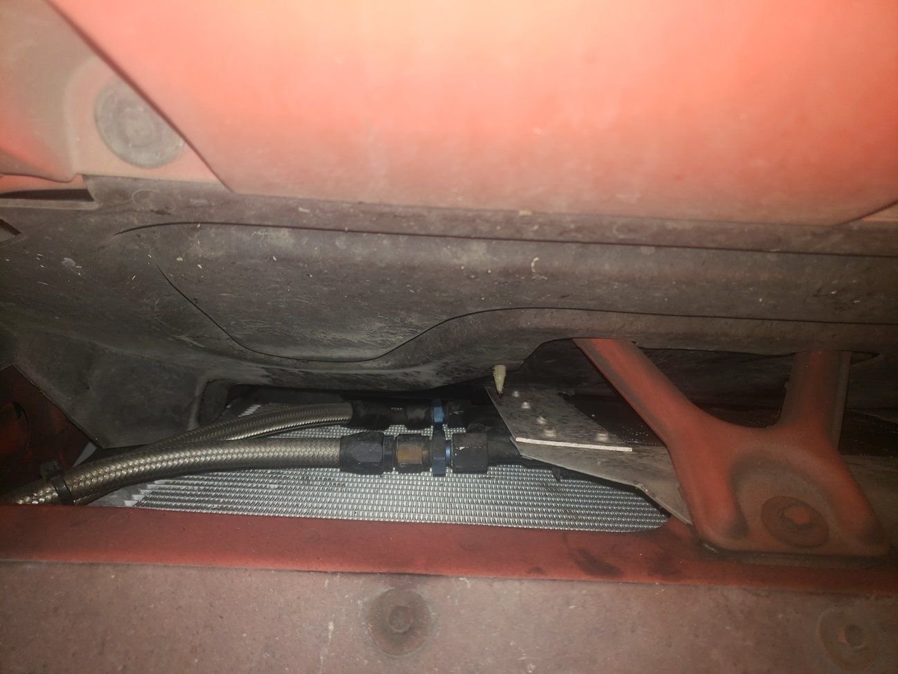

Try cut your transcooler supports a lot narrower looks like they are 2 inch each side. I have engine oil cooler, power steering cooler in front of my radiator and they have no effects on water temps.The supports are only 1/2 inch each side
The way i bleed the radiator is to , leave cap on , take steam vent pipe off engine side , put garden hose to steam vent pipe, it then bleeds out the steam vent tube engine side
Thats definitely why your iat is high , its sucking air straight off of the radiator. Id just fill bottom of air box back to front support.
