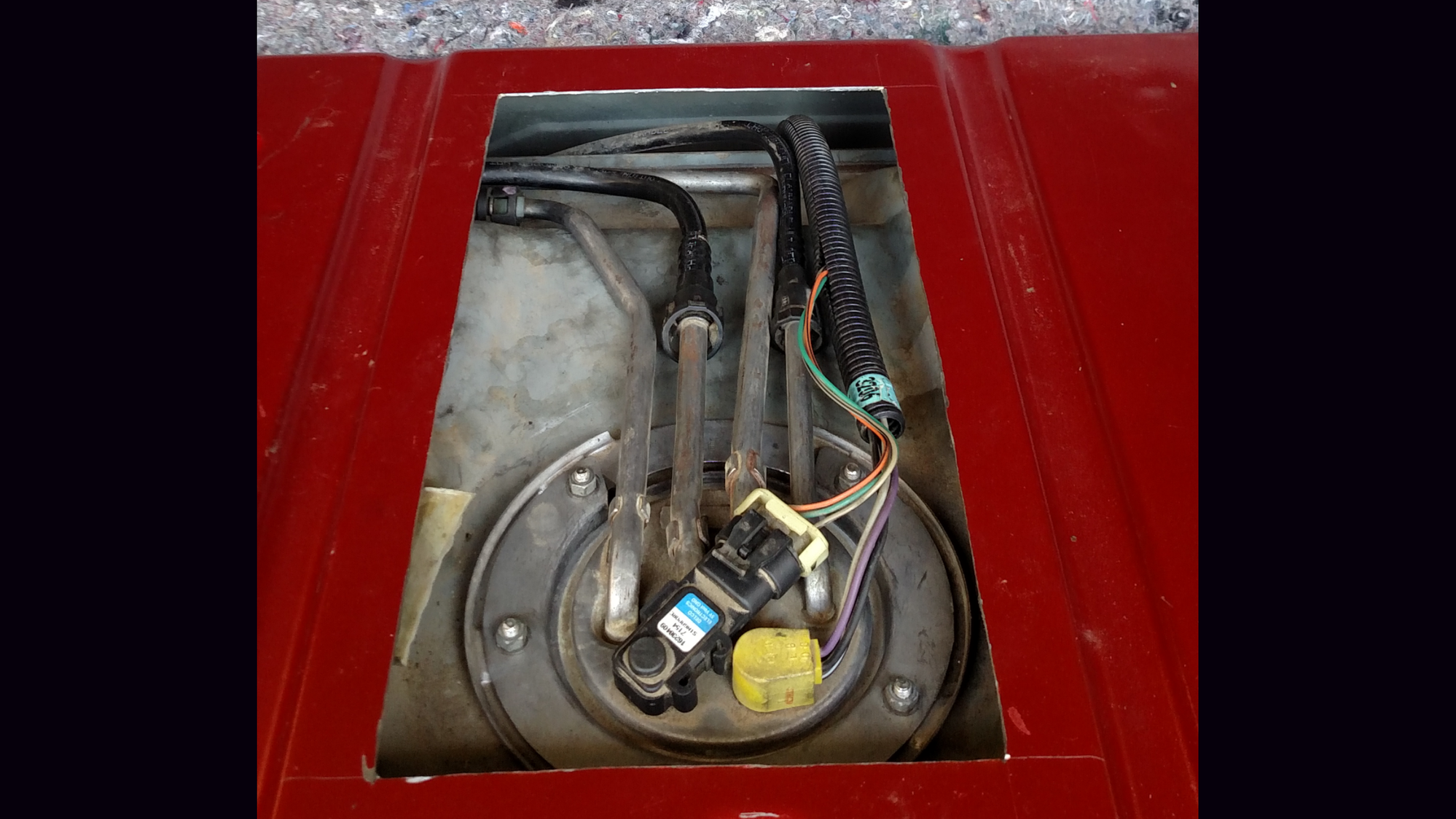

Cut a trap door in the rear for the pump.

Old May 27, 2020 | 01:51 PM
Here is mine.
How difficult is it to run the hotwire kit going the trap door method, and is there any risk of sucking up dirt / debris in the tank since I wont be draining it?
Old May 27, 2020 | 02:53 PM
  #60
ddnspider's Avatar
Posts: 14,628
Likes: 1,778
From: FL
Super easy to do the hot wire kit with a trap door. No risk of sucking up dirt debris as you're not disturbing anything on the bottom of the tank because you didn't drop the tank lol.
