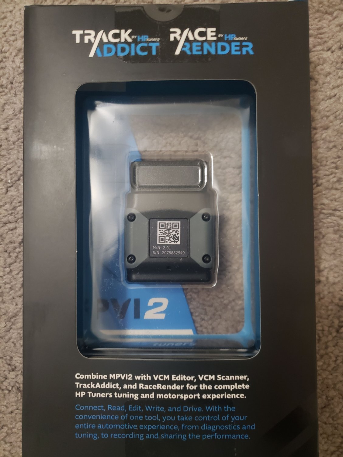

Finally recieved my HP-Tuners but I'm not so sure this is the right application. Is this what I should have received? I called Texas-Speed up over the phone and ordered a HP-Tuners but this device looks like it needs bluetooth pairing with an android rather than a cable hookup to a laptop. I havent opened it because if I do I cant return it if its wrong. I dont mind using Android so long as it retains the same functionality.
it should have a usb-c cable in the box that you use to connect to a laptop
