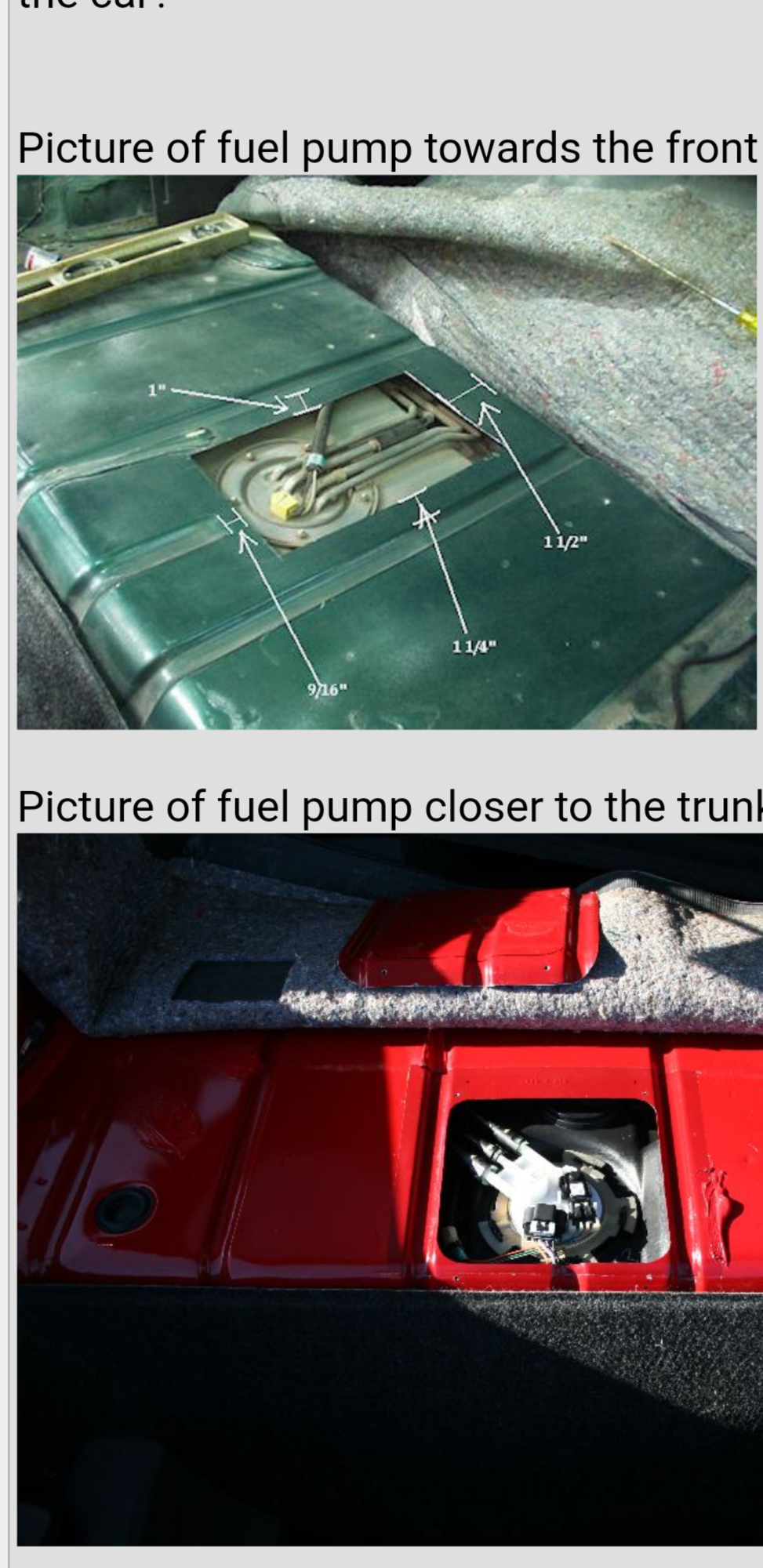

Originally Posted by Need4Camaro
How difficult is it to run the hotwire kit going the trap door method, and is there any risk of sucking up dirt / debris in the tank since I wont be draining it?
Super easy to do the hot wire kit with a trap door. No risk of sucking up dirt debris as you're not disturbing anything on the bottom of the tank because you didn't drop the tank lol.
This
Here are the measurements for cutting.
'98 is the top
'99-'02 botton
