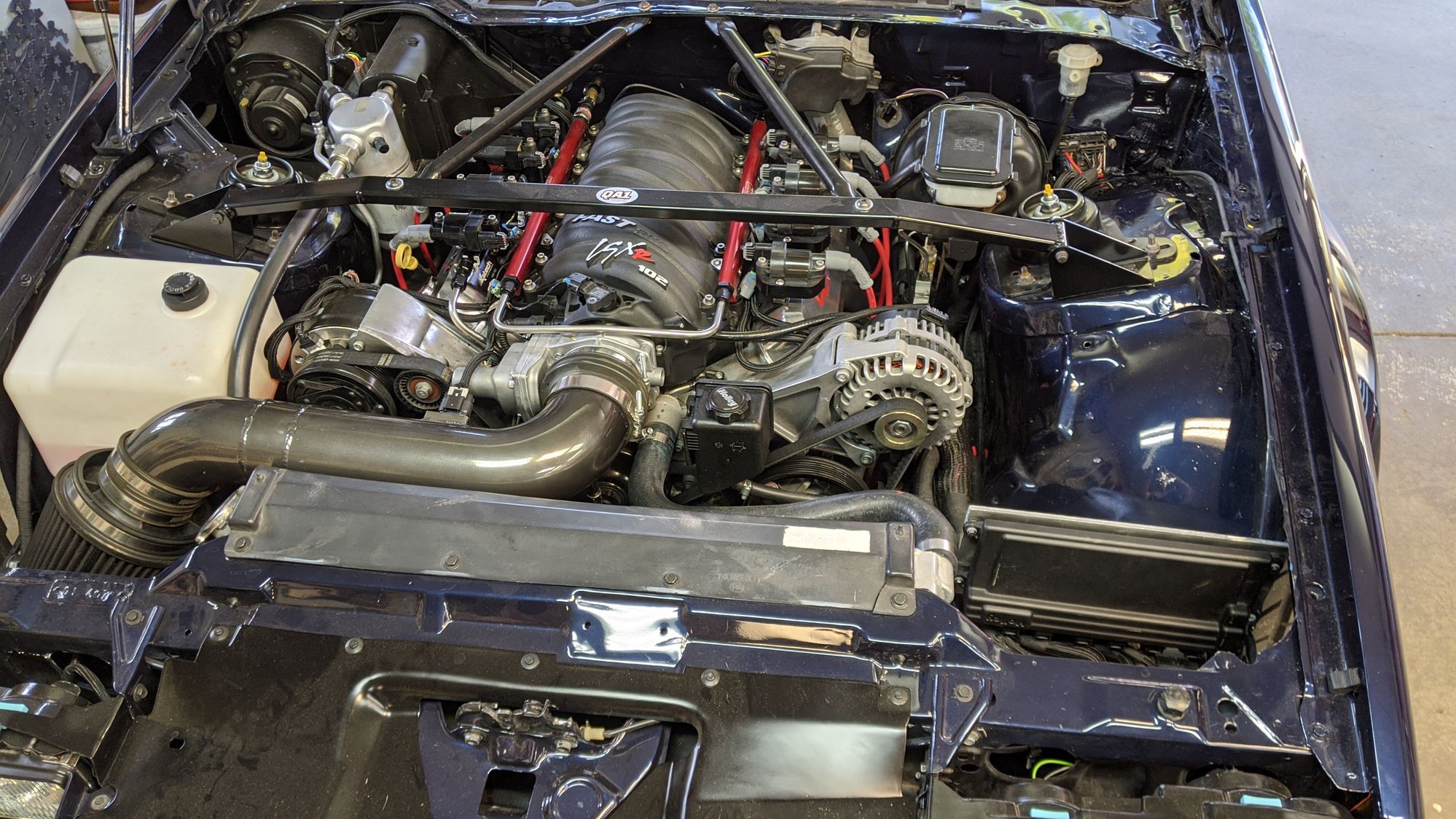

I had my GM ECU here and re-pinned the harness since the Dominator can take the engine heat.
