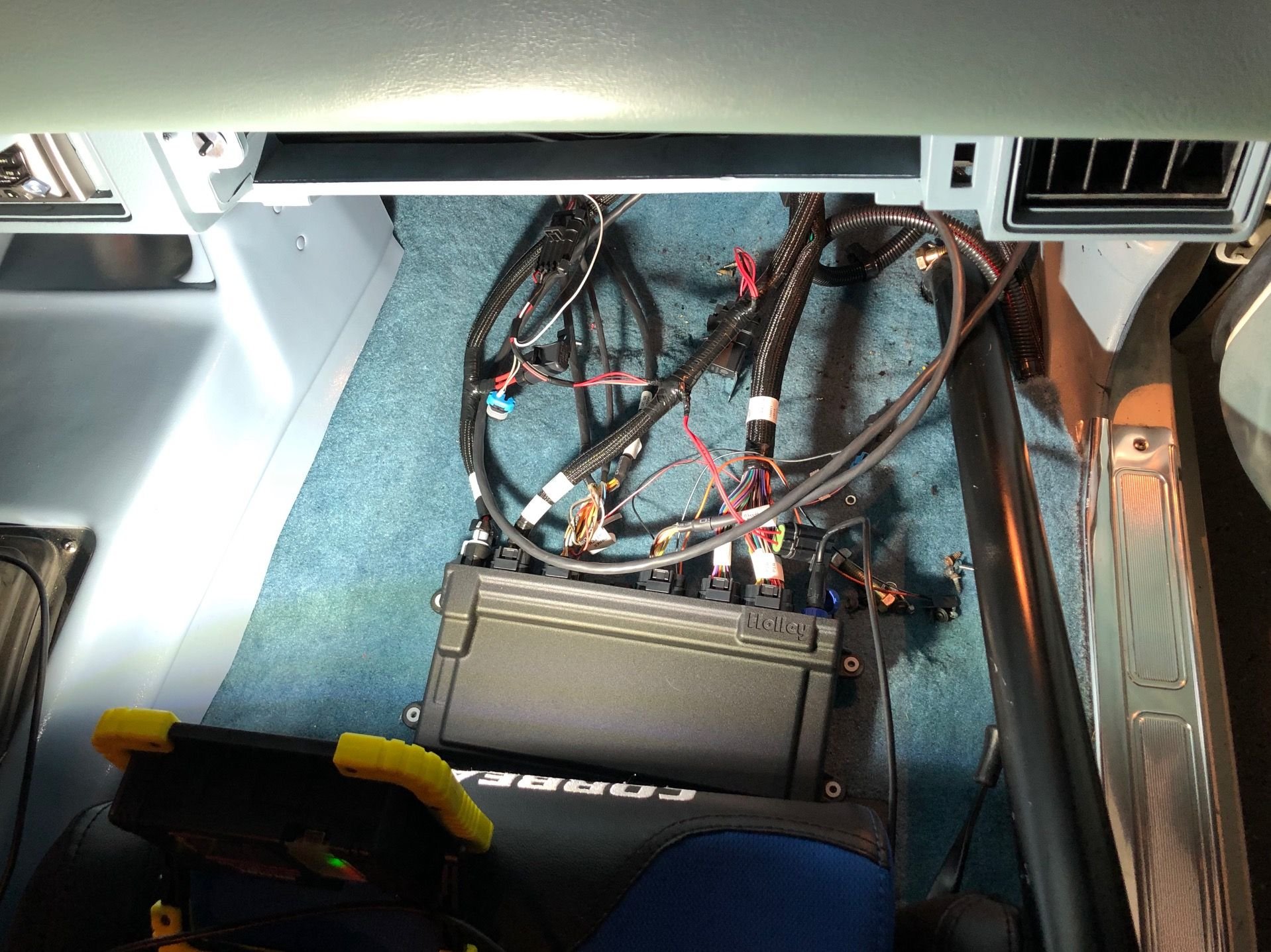

Has anyone mounted their holley dominator and distribution blocks somewhere in the back seat? I was thinking about making a rear seat delete that has a hidden enclosure that can be accessed/uncovered and then mounting the holley stuff under it. I want to be able to access everything easily without pulling the dash apart to get to it. I'm assuming wires on the harness would have to be elongated as most of the mounting locations I've seen have been on the firewall or on a metal sheet fastened to the passenger side cage door bar/floor bar.

In my '81 Camaro I mounted the Dominator under the carpeting of the passenger footwell. It is invisible there and still easily reachable.
The first picture shows it sitting on the floor during the initial testing . The second picture shows it mounted to the footwell with the excess harness draped around it and clamped into position. The silver is Dynamat heat protection. The carpet is folded up and ready to cover it all. My battery is in the trunk and the supplied power harness reached it fine; it runs under the rocker covers, under the rear seat and into the trunk. The big red cable is my main battery cable going to engine compartment.
