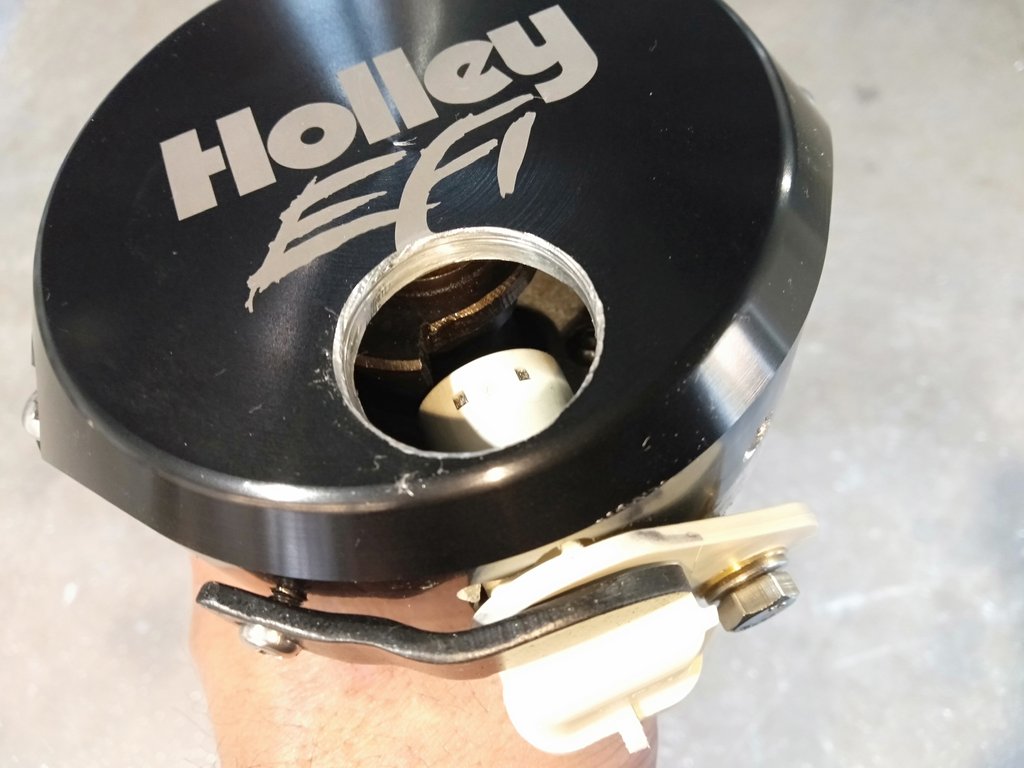

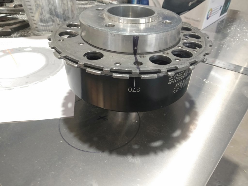

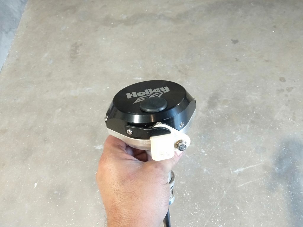

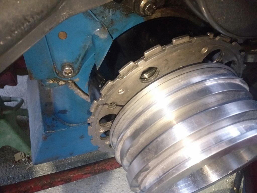

Decided to turn my old Holley dual sync into a 50/50 1x cam sync also fitted the 24x reluctor to balancer - being I'm changing my number 1 cyl to no5 cyl it will be setup at 270degees - cheers
