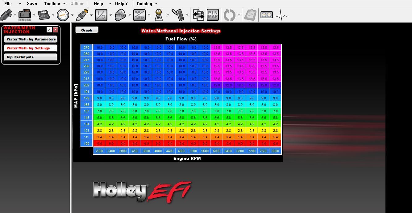

Just got my car together. Running the holey dominator ECU with Pro meth sniper 2 meth injection. Ran into some issues with how I have it wired or I have the setup wrong in the holley efi. After I filled the meth tank I noticed the Meth pump running at idle filling the charge pipe up with water/meth. I have the solenoid wired to a 12volt key for power and the ground is hooked to a spare inj driver circuit. The pump is turned on/off through the holley preconfigured output in the water/meth section. Does anyone one know what the holley uses to turn the meth pump on/off? Its output is in the water/meth section and does not give the option to configure it.

Yes, I have fuel flow % starting at 117KPA and ramped it up from there.

I think the holley meth setup is intended to use a solenoid valve at the injection point (Like an auxiliary injector-but for meth)

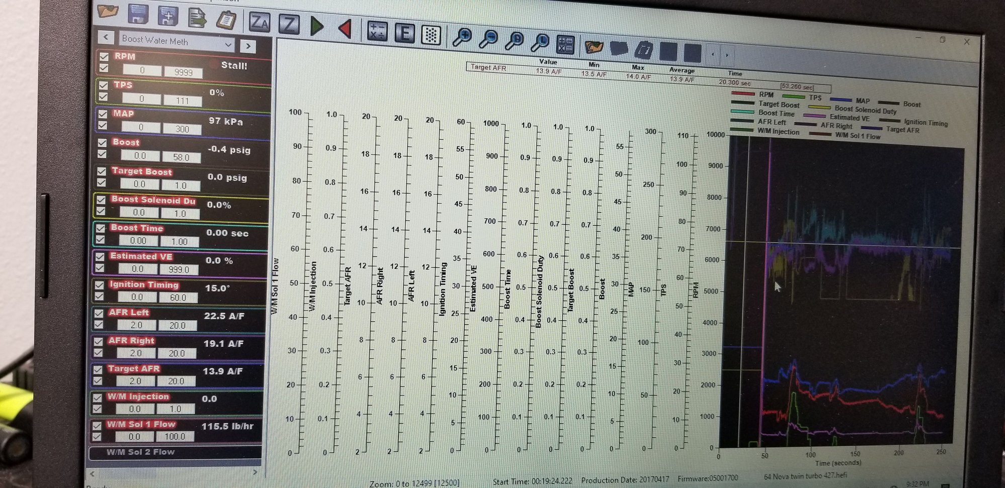

I noticed the W/M SOL1 flow is always at 115.5 LB/hr. It shows 115.5 at idle with the W/M injection settings all set to zero. Is this the ecu trying to flow that amount or is that value the max it could flow?
