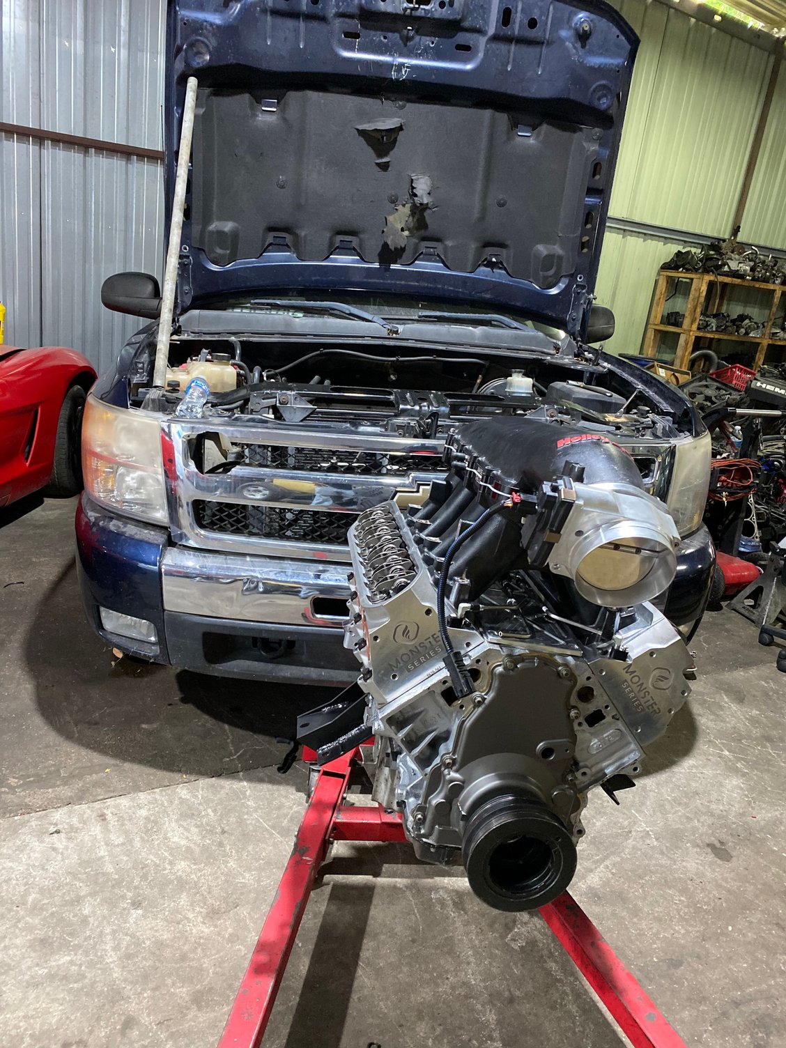

What’s some pros and cons on speed density tunes?
A little bit about my set up is
419 stroker
m311 heads compression should be at 11:8.1
holley high ram intake port match runners
112 mm TB
5” air intake e85 fbo
nitrous express Holley plate kit thinking about spraying 250 shot

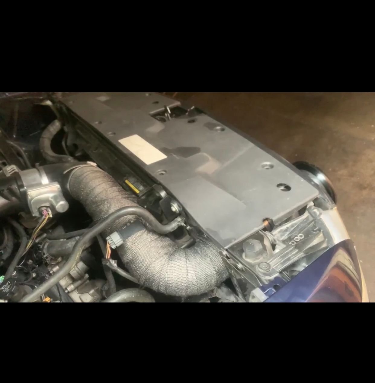

My air intake will be something like this but in a 5” pipe.
my previous set up I was using a 4” air intake 0821 heads no nitrous 102mm TB but now that I’m switching to 5” and heads 112mm my tuner told me the best thing to do is speed density but idk how is going to work out. Or what to watch out for. This is my Friday street racing truck/ Friday/Saturday take it to work not a daily by any means!
