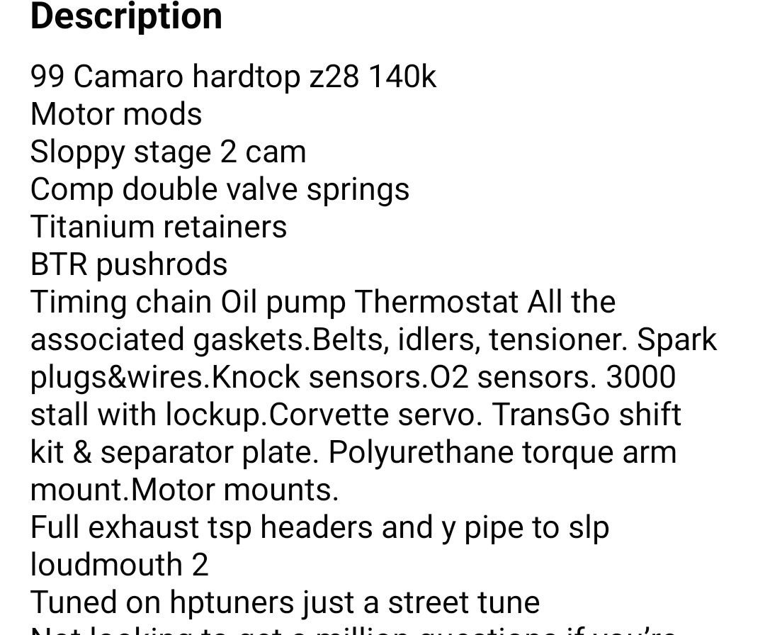

Can anyone tell me anything about my tune. Bought car a few weeks ago. Just bought the HP Tuners unit. My issue is cold start. It will stall unless I play with the gas for a minute. Then she runs fine. The first log just idle was a warm start so no stall.
