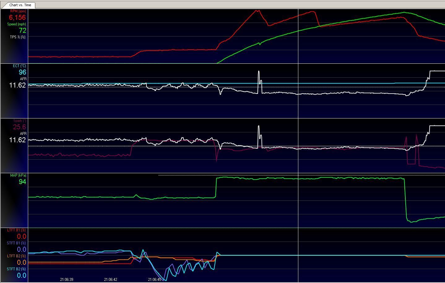

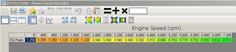

Fine tuning/scanning for a track day yesterday car was found to be very RICH, like low 11 high 10 AFR. I'd swear on last track run it was around mid/high 12s AFR. PE tables were around 1.17xx range.
But yesterday in order to get the AFR on the wideband to be in the high/mid 12's where I wanted it I really had to pull a lot of fuel from the PE table especially near the top, and it's STILL a bit rich (but close enough, lowest points are 11.6 but almost all in the 12's now):
The only change I think I made was a HOTWIRE kit for the SAME STOCK fuel pump, could that make this much difference? I know the computer is somewhat blind at WOT and it's mostly guessing for AFR based on my PE multiple.
COT is off (no cats) and the Open Loop F/A vs. Coolant Temp vs. MAP is all 1's. Temp Delta is zeros all around the temp range car was operating in. From what I am reading here, with COT off the car will choose richest value between PE and OLFA (unless I'm referencing the wrong table...? I think that's what OLFA is). I don't yet have fuel pressure because I don't have a gauge handy but that's my next step when I can.

Here is what it looked like at the track (below). (Note that the above PE table is actually pulled down maybe another 10% since the below track run but they're close, it's all in the 12's now, this is the graph from the track because it has more data than my tiny test pulls).
I have AFR graphed twice, once with a 14.7 reference line and the other is a 12.8 reference line.

You were probably dropping fuel pressure before when you tuned it. Correct the VE table and then set the PE back to the desired afr

Mystery solved.
Pulled my old tunes and actually even had a log from my last track day. One thing I forgot. Between then and now I decided to bump up shift points and rev limiter (was stock, went to 6600ish), and never tuned the PE for those high RPM areas because the car never revved that high at the time I was tuning with the wideband.
At least it was erroring on the RICH side not the LEAN side LOL. This is a good excuse to get a wideband gauge I guess.
Still would like to know if having 0.6xx numbers in PE is bad voodoo. Seems other tunes I see are all greater than 1.00
