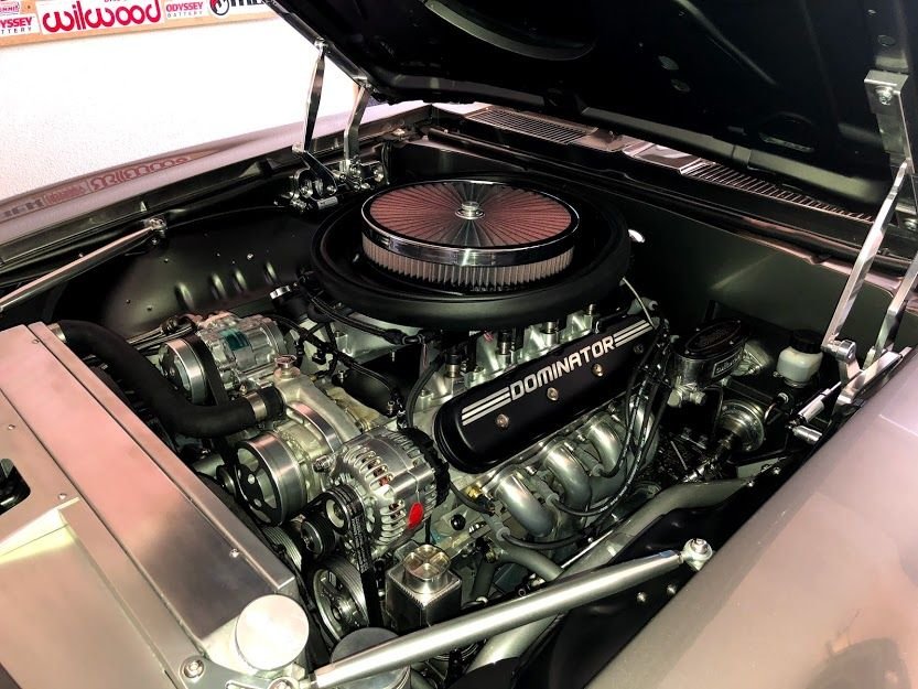

Hey Guys, I have an LS3 running an early (2001) 24x crank and 1x cam sensors. I'm also running Holley intake, injectors, and a Holley 4150 style throttle body. All this said, my engine starts immediately on every other try whether hot or cold. My fuel pressure is holding 60 psi. Every other time I start the engine it just cranks and won't fire. If I keep cranking like for over 2 seconds it sounds like it coughs (not a good sound). I have gotten used to just turning it off if it doesn't fire immediately and then starting it again and it fires right up. I am not getting a fault code light or anything. It just has this weird starting issue. I have changed both the cam and crank sensors and I have a Speartech harness made custom for my components.
Just wondering if anyone has any experience with this type of problem? I would think right off it was the cam sensor but it has been checked and replaced just to be sure.
Thanks in advance!
