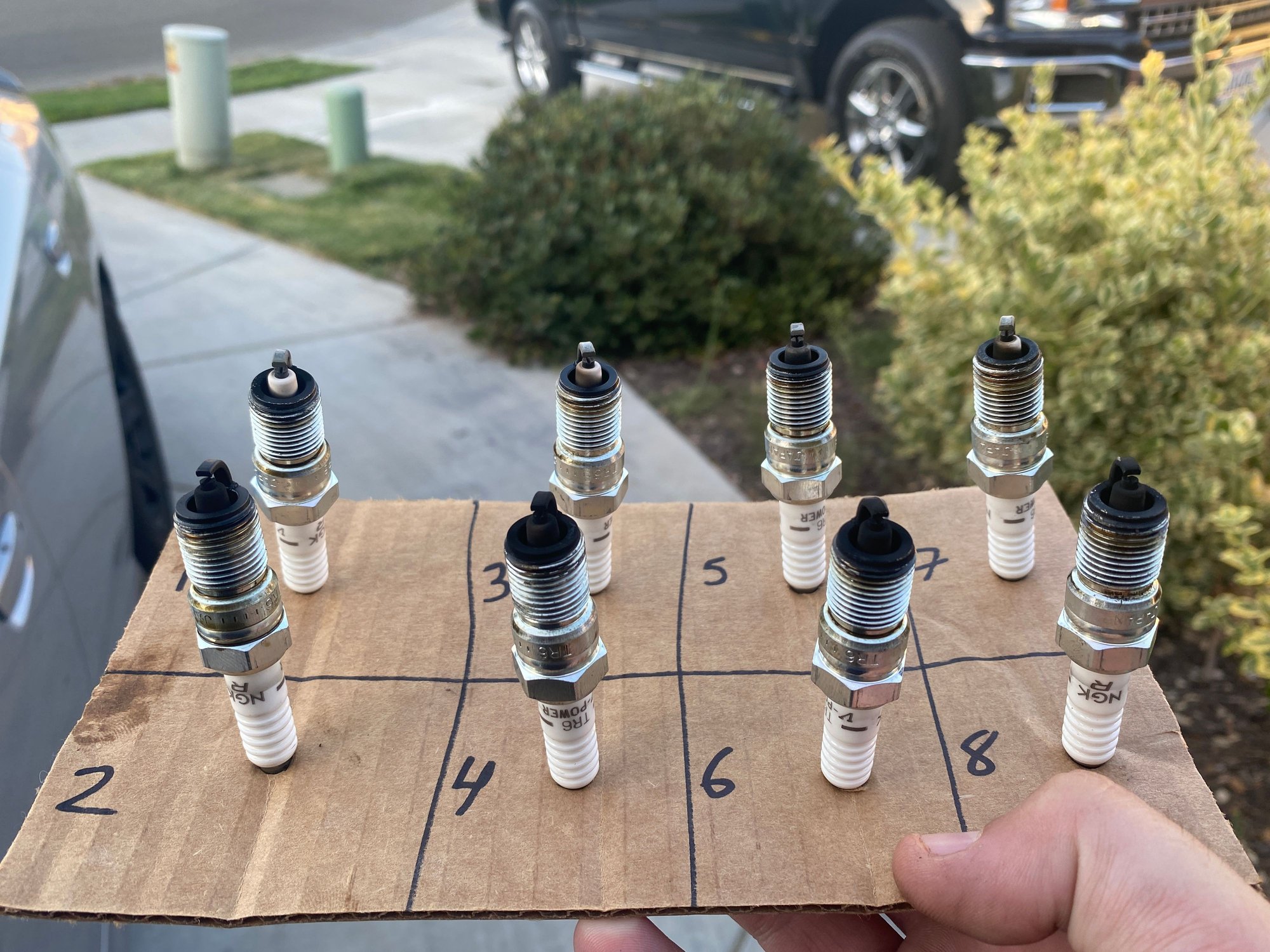

Pulled the plugs
Bank 2 rich, bank 1 normal. Guessing fuel injector issue.

Possibly O2 sensor or exhaust leak close to the O2 sensor on that bank? I’ll have to fire up my laptop to checkout how my Maf graph is plotted.

well my o2s were wired up correctly... and I ended up getting my injectors cleaned and flow tested. They were off a little and one injector in bank 2 was clogged.
also I think my fuel pump is starting to wear out as I noticed it’s only making about 60psi (pre FPR) and at one point the pressure dropped to 50..
wiring is good on the FP.
also no exhaust leak prior to the o2 sensor.. down the way there are some as the exhaust is slip fit.
