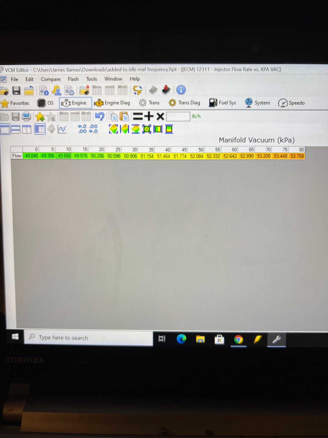

attached are my IFR values and after HPtuners auto correction when entered they are all exactly as sent
EDIT:
is it possible I am nearly out of pump. I.E. under WOT I’m dropping rail pressure slightly and compensating for it by tuning over top of it? AFAIK cyl air mass is based off your VE or MAF scaling.

Yeah, if you can't trust your fuel pressure, you can't calibrate it based on fueling error. That's always a risk. But my concern was more about you saying they are 42lb injectors but the table there saying they are 49. Seems like you have the wrong data?

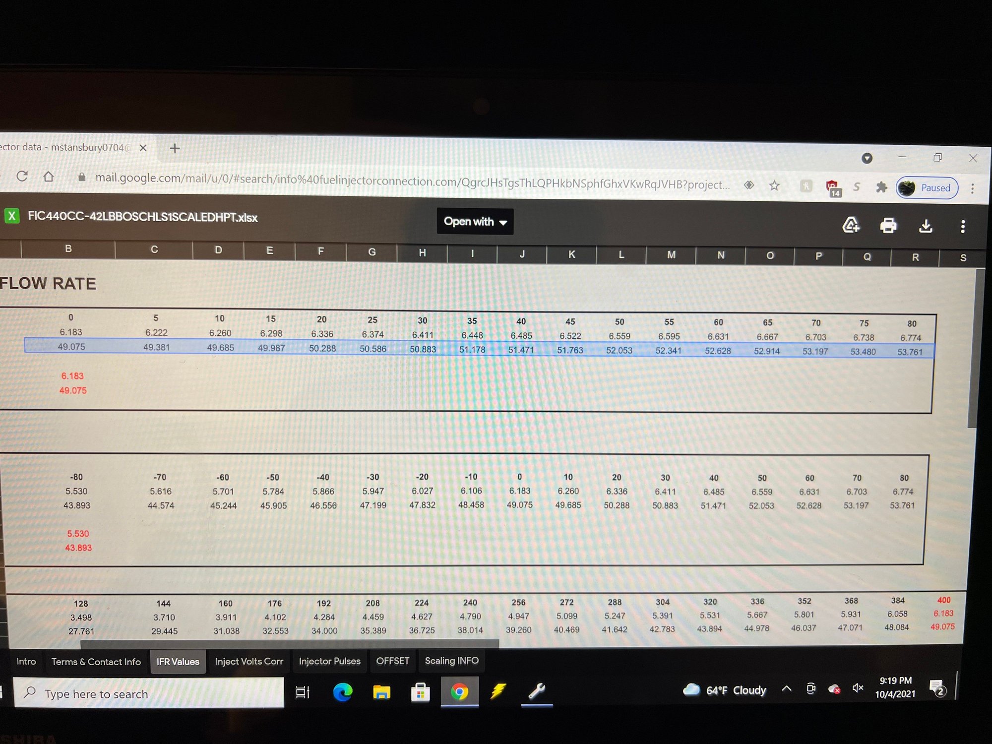

EDIT: Im pretty sure these are Bosch 0280155868 Which are infact 42lb at 58 PSI, but idfk how they get their data of 49...when taking the bosch rated 36 at 43.5 and multiplying by the 1.1547 you get 41.56...Is this a case where my ENTIRE set of values is wrong, such as my short pulse and my offset, or I can just update my flow rate vs kpa data?...Im pretty pissed off...I dont even know how to rescale this data at this point because i dont understand how they get their base rate of 49... Im so mad i didnt notice it was off. Teach me for trusting a vendor..
Edit#2
attached is NEW data. Ive updated everything along with min fuel mg and FTW impact. These base IFR values are nearly 20% less than what i had currently, how does this effect my VE table? Im grinding gears wrapping my brain around if i should add 10% of fuel or remove 10% for my initial logging. My startup airflow tables shouldnt be severely effected correct?? Im hoping i can just slap this new data in, retune VE, and MAF and be okay...heres to being hopeful

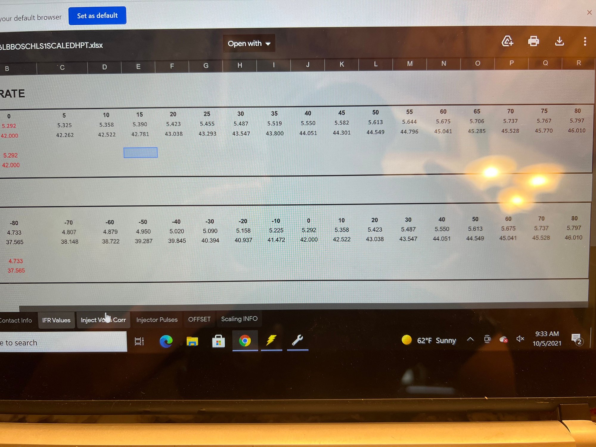

This is what FIC just sent me when I asked them again for the injector data. The data I just updated I stole from hptuners forum. The real question is now, which is right?
Attached is tune with FIC injector data.
