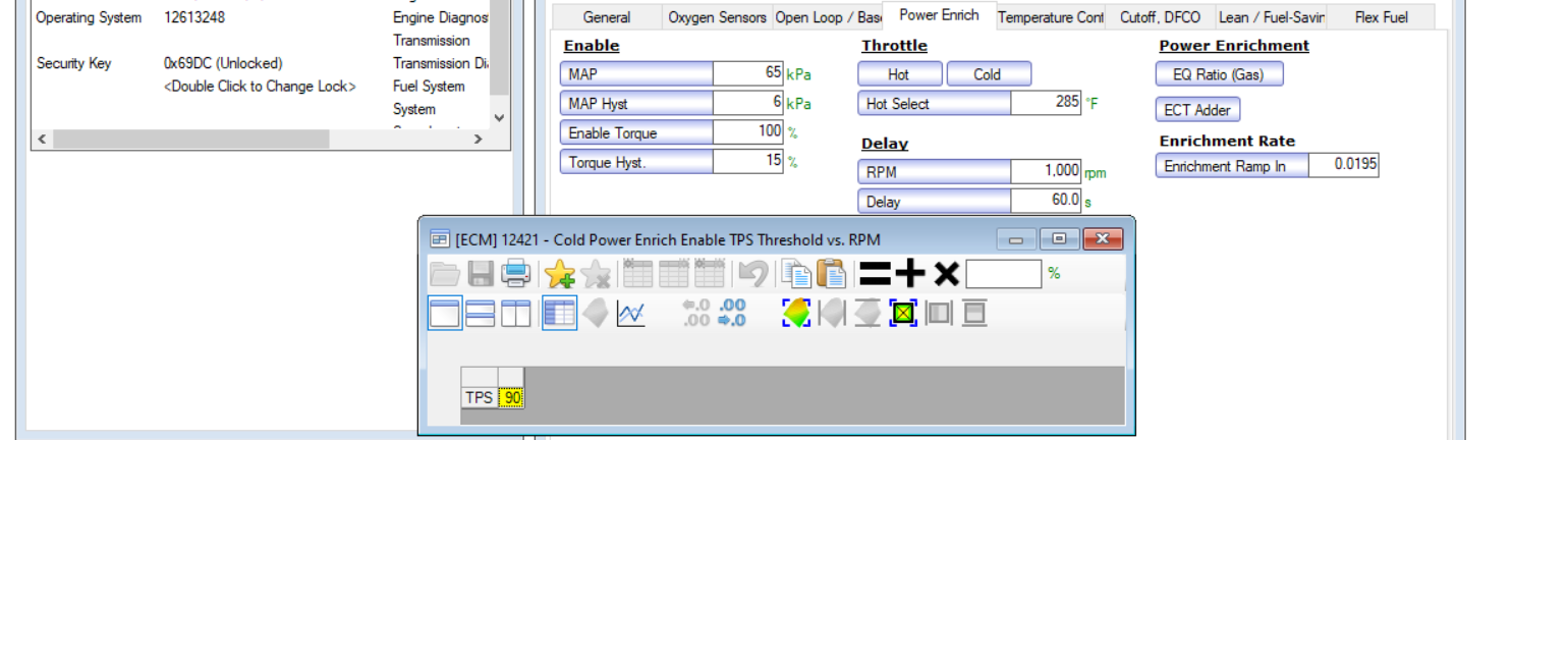

I have a 2007 6.0L LQ4 in my jet boat with the GM PCM and EFI. When I built it I kept the O2 sensors by placing them in the risers which are water cooled. I removed the water jacket where the O2 goes through, but at idle it still cools them off too much, so they start adding fuel until the fuel trims go to +25 at idle, then the O2 sensor finally shuts off when the PCM realizes its too cold. I want to make it open loop at idle but I am not sure how to do that. Any thoughts would be appreciated, as so far these are the only solutions I have come up with.
1. Use the PE mode. The issue with this OS is that the TPS PE threshold has only 1 option instead of being setup to go by TPS and RPM. See attached image.
2. Edit the Hex code to extend the enable PE mode table so it also goes by RPM. I spent an hour and a half to realize that this is above my head at the moment.
3. Use the shift light output, a relay and resistor to trick the motor into thinking its to cold to be in open loop when below ~1500rpm. The issue is that it looks like the max on time is 410 seconds.
4. Switch to another Operating system. The issue is that I am using the 2007 van ETC throttle pedal and TAC which are 1 year only. I am fairly confident that they will not interface with the 2003 12579405 OS that I have access to. I don`t think the 2005 12592618 OS will work with that TAC either.
5. Use lean cruise to go open loop. The issue I am having is if I set it up to go into lean cruise at idle RPM and 0 MPH since I have no VSS I don`t think it will go back to closed loop at running RPM.
Any other ways to go open loop at idle?
