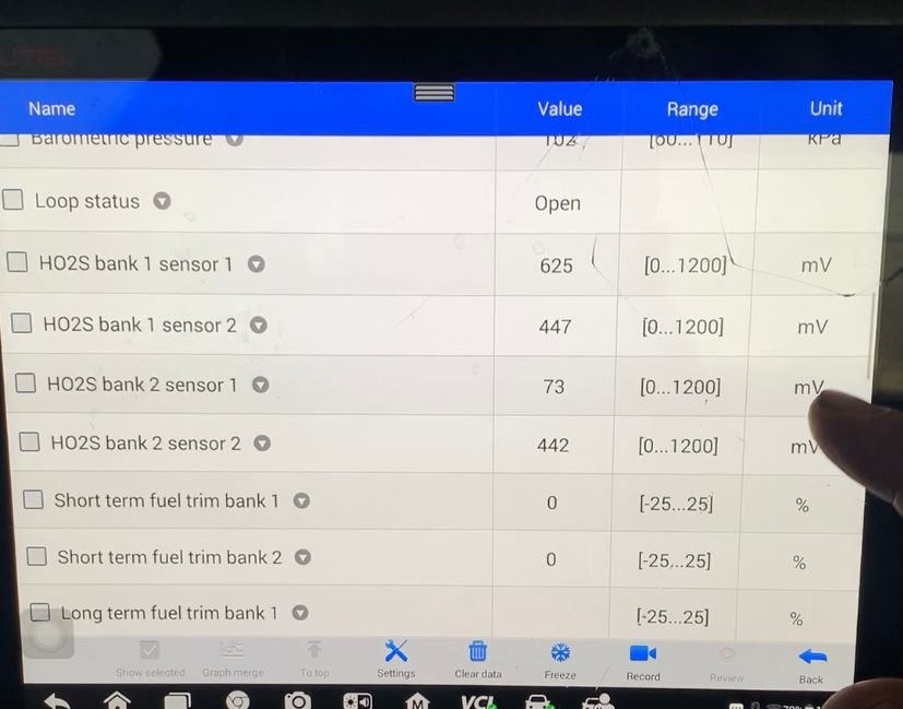

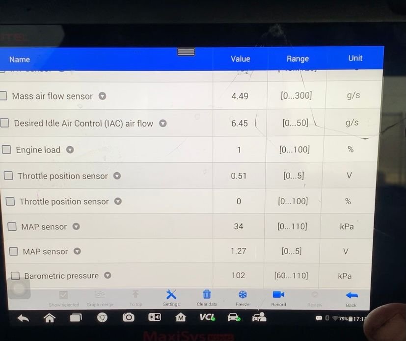

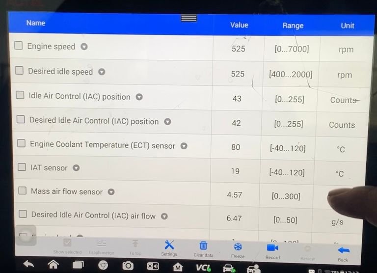

Seeing if I can upload the live data so you guys can see if something looks way off
Old Jan 27, 2022 | 08:44 PM
Glennspec's Avatar
Joined: Jan 2022
Posts: 7

What is the wideband telling you when you crack the throttle to the dead spot?
