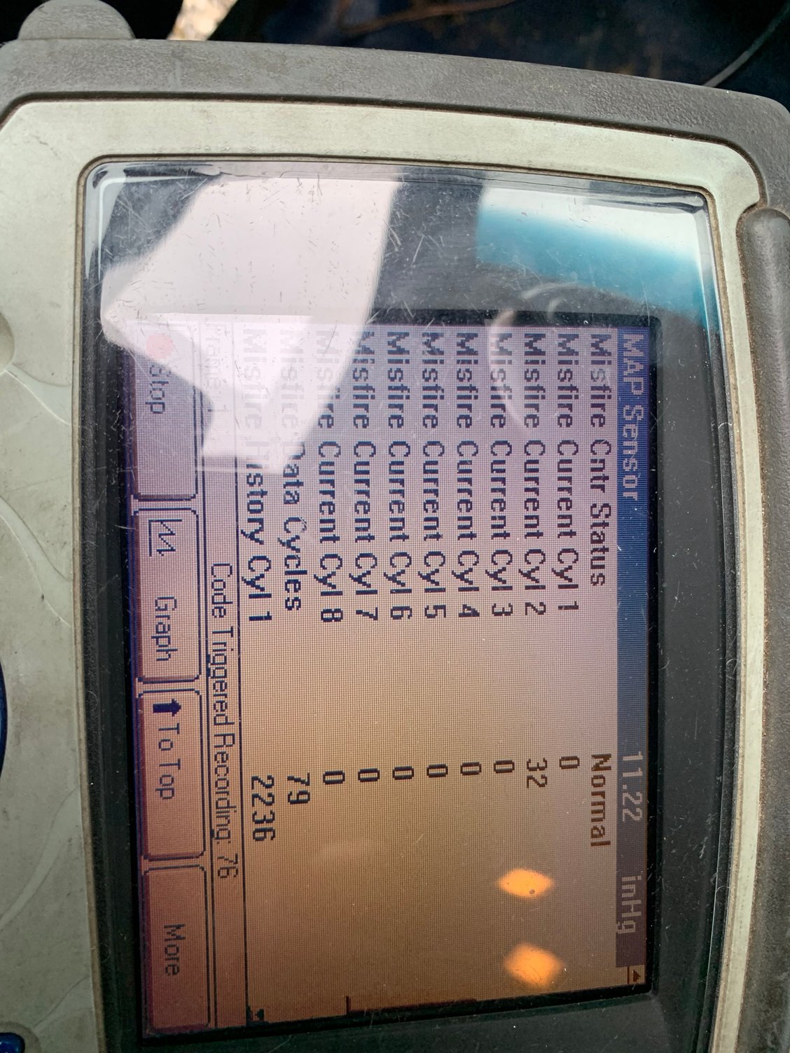

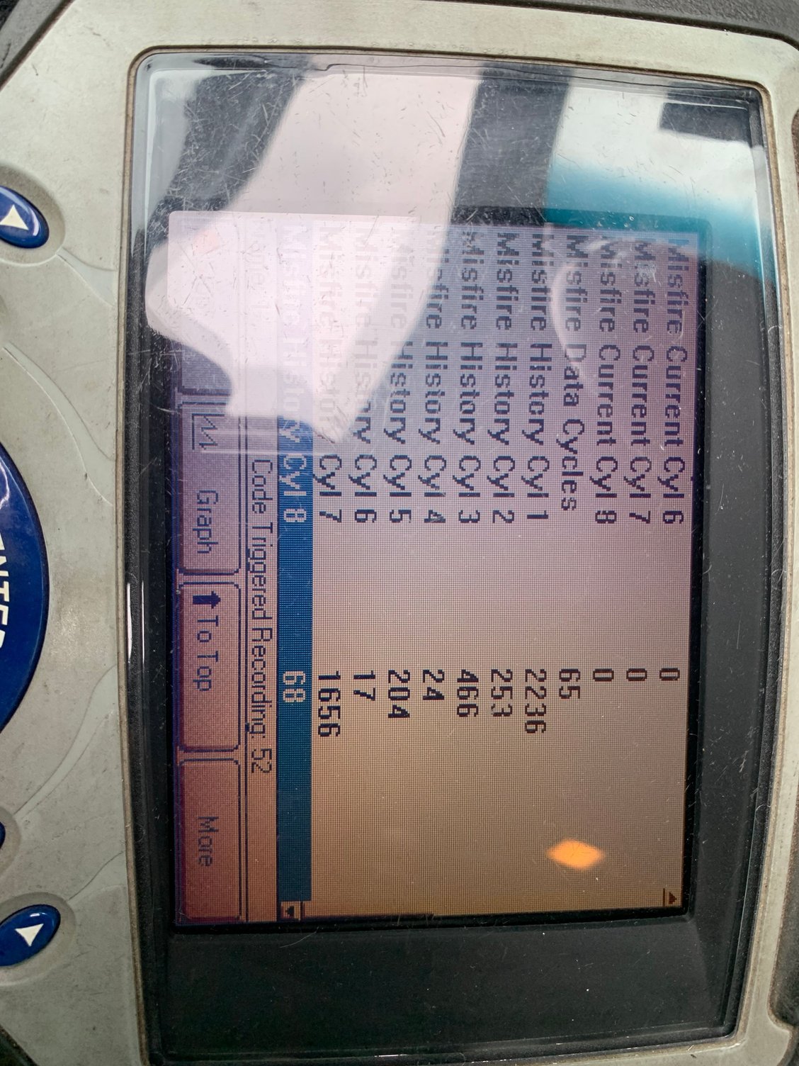

the truck starts and idles fine, but it’s clearly lacking power. Once it’s out on the highway it’s really
noticeable. Watching the live stream, cylinder 2 consistently misfires. Looking at the history it shows all the cylinders misfiring. Before I go changing parts os there anything obvious I should look for?
All grounds have been landed. I use bare ring terminals, crimp and solder them. I’m pretty confident it’s not a ground issue, but I could be wrong?
Ill include some screen shots from the scan tool.

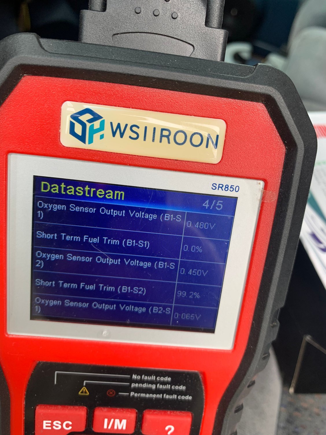

Vacuum leak is something I’ve considered. Looking at the picture I took of the scan tool, it shows 11 inhg at idle. That’s pretty low and makes me think there’s a leak.
I will pull the plugs to put my eye on them to see how they look, that’s a sure way to tell.

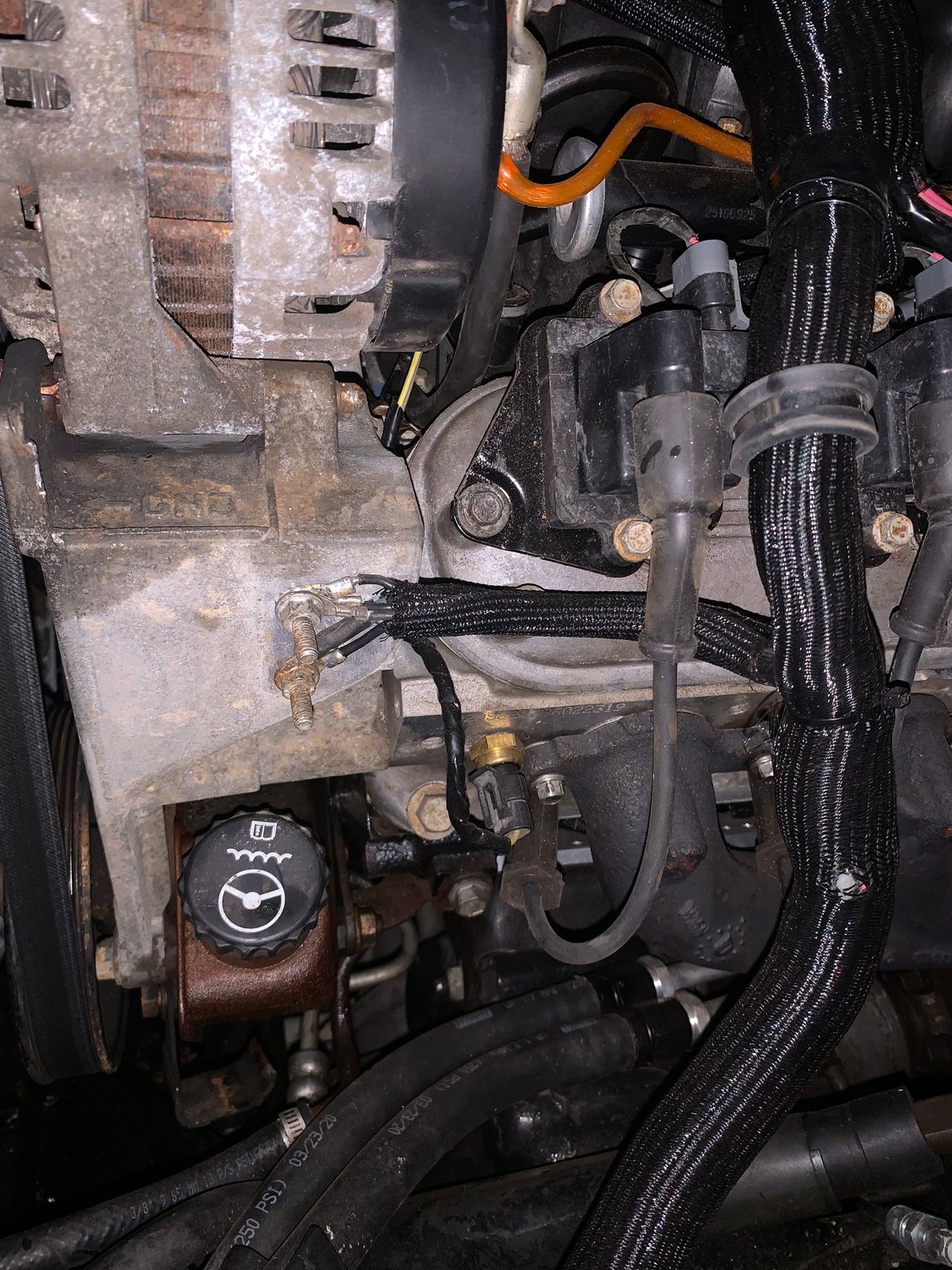

I went out to look at the engine just now to see if I could find something obviously wrong, like a vacuum port left open. No luck there but I did see this and it make me think. I landed the drivers side grounds here in this picture. Would that cause me problems? I can easily get a 3/8 ring terminal and land them on the cylinder head if it matters that much.
Also, I got new Bosch O2 sensors, was that a bad idea? The style the engine had originally did not have a fused power source. Could they be causing these problems?

I moved the ground from the accessory bracket to the cylinder head with no change. Checked all the connections with the ignition and everything is tight.

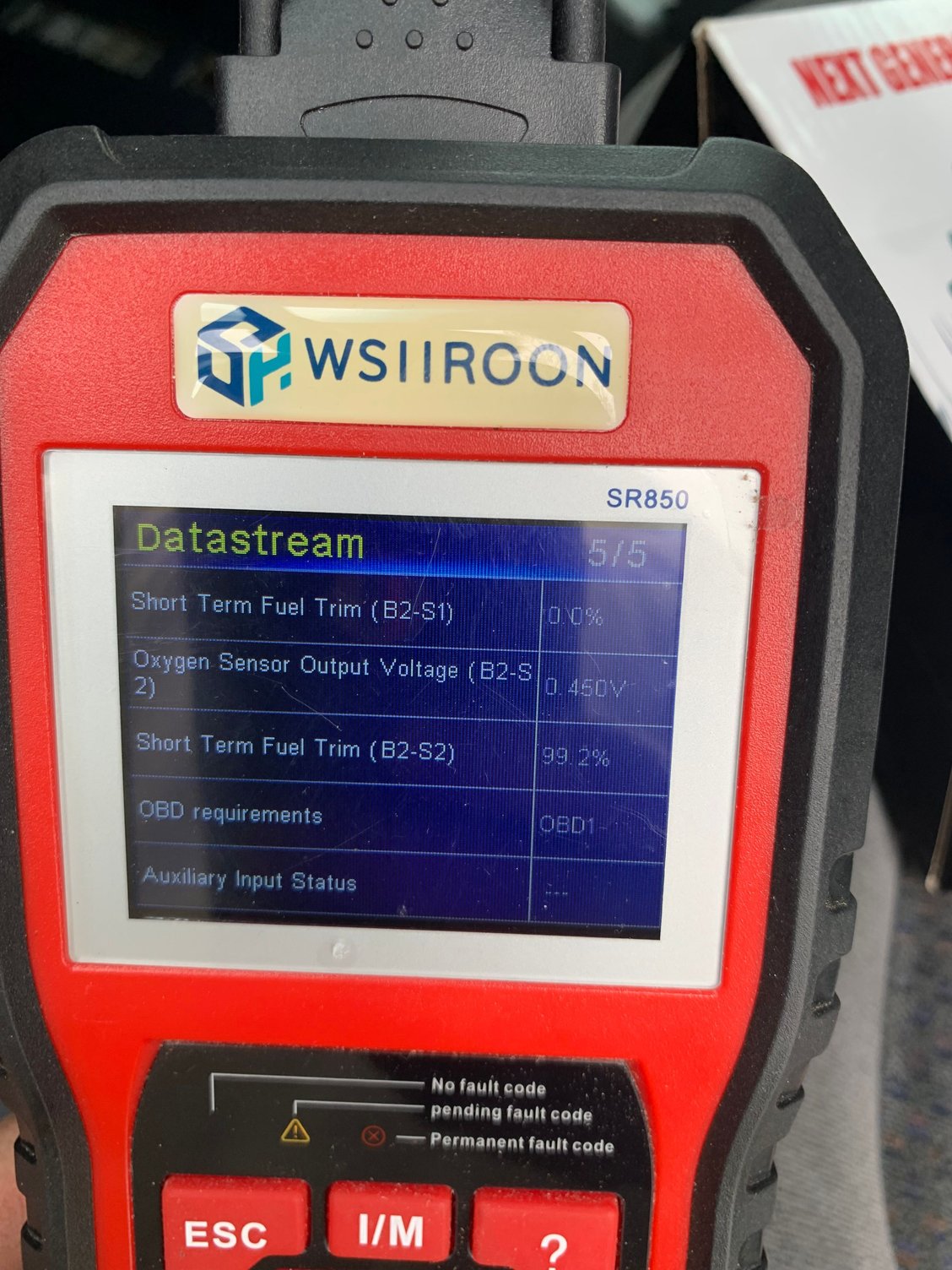

Some more information, I changed the map sensor, checked the vacuum with a od2 tool, it showed 11”, while mechanical gauge showed 17.5”. So I am unsure how to correct that problem? Unless a table is scaled wrong?
looking through the data stream while it’s running I am getting readings from all 4 O2 sensors, but I removed everything involved with the rears. I wonder if I had done something in correctly. It never went into closed loop either.
