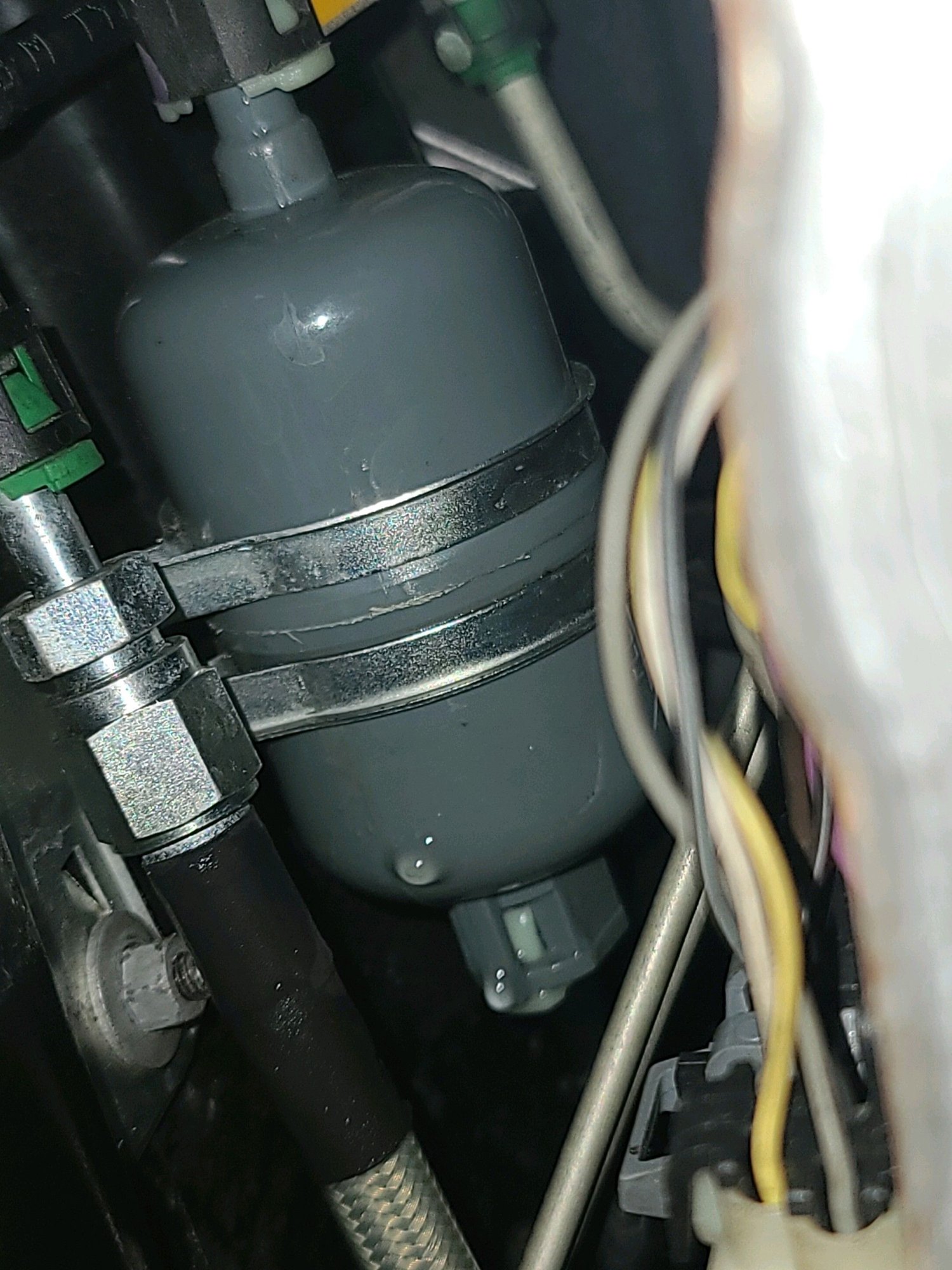

Updated Tune again...hoping someone can jump on and provide feedback. Car still won't start on first crank after sitting for a while but starts immediately after it's been driven. I've also started to be overwhelmed by gas fumes and after driving today it smells like its actually coming from driver rear tire. Thanks in advance for any feedback.

The fuel pump assembly is directly in front of the left rear tire under the alum cover. It’s easy to remove and have a look.
The fuel filter/regulator is beside that up by the transmission. You should check that as well.
I’d want that issue fixed before any further driving.
Thank you...I have the A&A kit installed and will look at it once I get it on the lift. Do you see anything obvious with the tune or log? Thanks again.

I appreciate the help...is this the factory fuel filter?

Factory filter looks like this
So that does not look stock. I’d assume it been changed as part of the blower kit?
Obviously leaking though

Yea it came with the A&A kit. I replaced it but it was leaking because the hose wasn't completely on it. Do you see anything with the tune or log?
