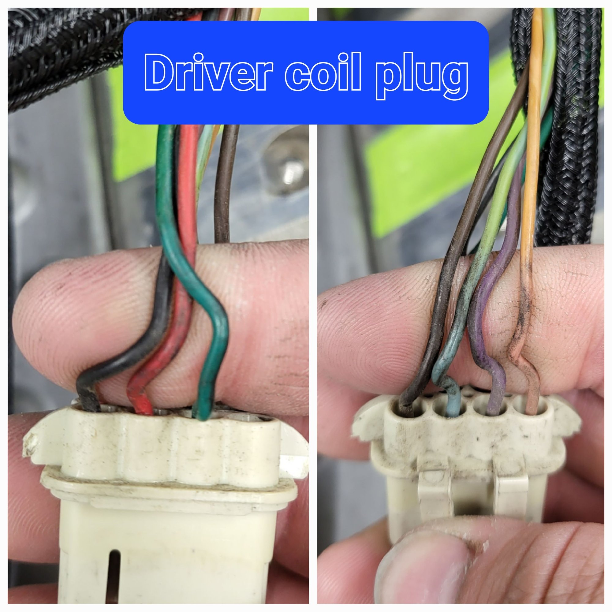

I figured it out! 5 and 7 coil trigger wires were switched at the male main plug. Even though I double checked it a few weeks ago I still over looked it some how. I knew it had to be something small I was overlooking.
I want to thank everybody for all the help and suggestions!

Welcome! Just this topic alone that I searched for I came across too many threads that didn't post a final update, so yeah it got pretty annoying
I really only came across it when I was reconfirming the continuity of the trigger wires between PCM and coil and noticed 7 wasn't registering

Uploading this for @blackbirdls1
