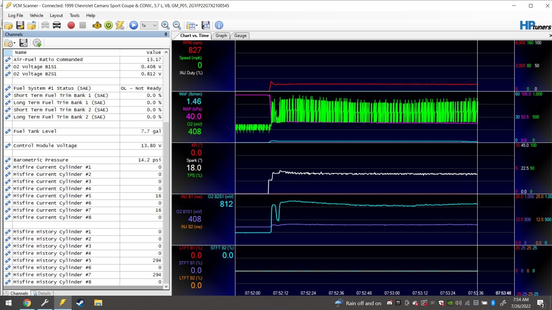

I tried the battery drain and re-wrote the pcm to no avail. Would a test-light light up when pcm triggers the coil on the signal wire like a injector noid light? I tried it and it wouldn't light up. With the DMM hooked to ground and positive on coil plug red wire, I wiggled the harness around with zero fluctuations on voltage. Same with the 2 ground wires (black and brown wires). I'm at a complete loss on what to try next. Wish I had another pcm to try.
All I did was pull the PCM and store it in my top drawer toolbox for about 5 months and then reinstalled it. There's no way I damaged it or anything.
Here's a screenshot and quick log file of a cold start

How come the scanner says it's 5 and 7 misfiring, but when I command injectors 5 and 7 off it starts stumbling worse?
​​I found its 3 and 6 with zero idle change and the popping stops which is the exact same result when I unplug injectors 5 and 7. So what's right and what's wrong?

What's correct is your unplug test. 3 and 6 are misfiring. Might be worth checking the plugs and cranking compression on those two cylinders. Easy way to verify spark is to unplug the injector and leave the spark plug attached to the spark wire, but out of the motor with the ground strap touching the motor. Get someone else to crank the starter and you will either see it spark or not.
I don't follow the first part. If I physically unplug cylinders 5 and 7 injectors while running, there's no change in the idle and the popping in the exhausts stops. Makes sense cause the unburned fuel is no longer being dumped in. Hptuners scanner says those are the cylinders misfiring. So then if I plug them back in and go into the functions, why is it I have to command injectors 3 and 6 off in Hptuners but in reality it is actually 5 and 7 injectors turning off? Are they labeled wrong under the functions?
I've already unhooked the the plug wires on 5 and 7 while running and there is spark

Based on this earlier post, cylinders 3&6 are the problem.
Either way, if you have spark and fuel and still misfire then compression is the next check.
