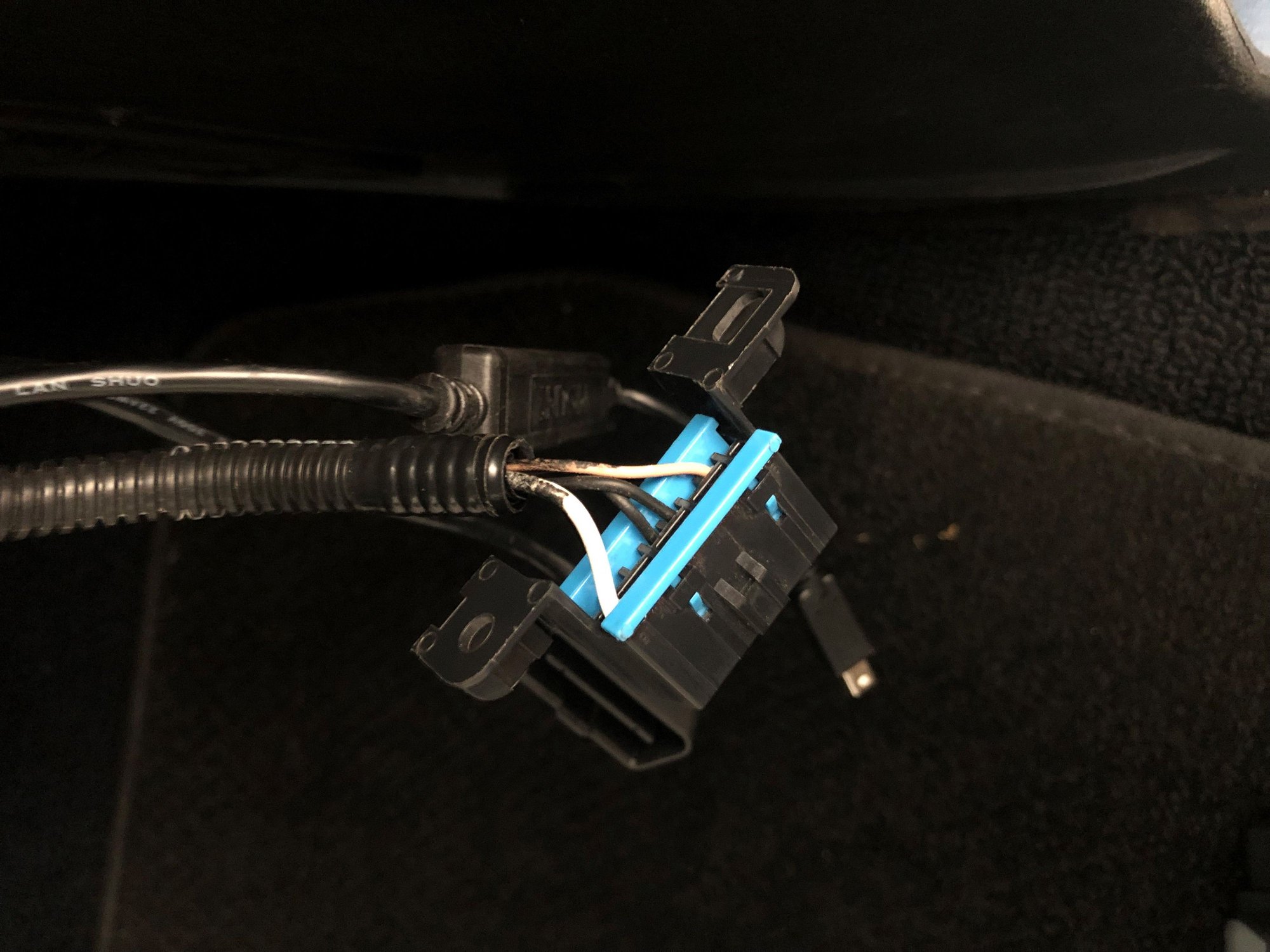

Hello a little update, I installed the wideband and richened it up enough so I didn't blow it up ( in the past 2 weekends I put over 500 miles on it )
I can definitely hear a miss in the tail pipes but my VCM doesn't pick up anything on the misfire, spark retard or knock sensors ,I'm not sure if there working I have a PSI harness and I'm
not sure if there are enough wires going to the OBD2 port there's only 4 and there connected to the#2,4,5 and 16 port or if something is turned off
Its still taking a bit to start and not idling well and is down on power but im trying to figure it out
Thanks for any help or direction

Old Oct 19, 2022 | 05:13 AM
gagliano7's Avatar
Joined: Aug 2005
Posts: 2,305
Likes: 126
From: Monroe,NY
Amazon Amazon
Looks like yours is correct.
