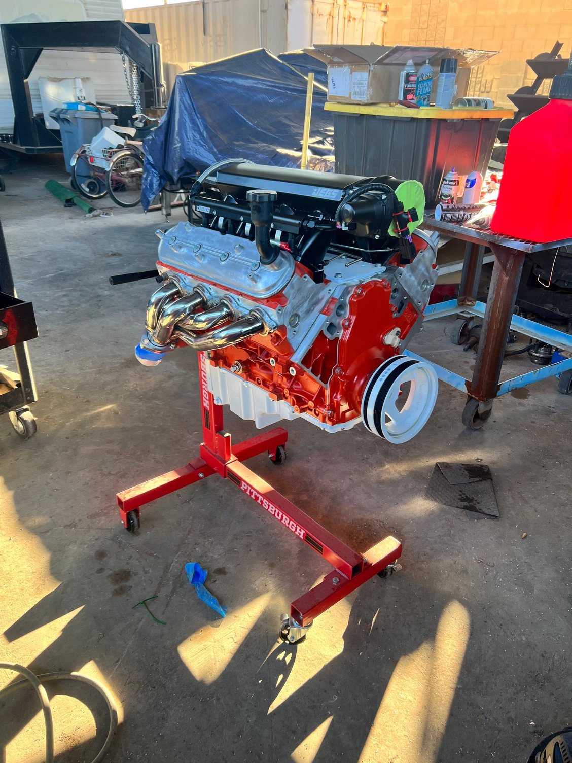

I am swapping my L59 for a built ATK LH6 that I picked up for $2,400.00. I already have the Camaro water pump for it. I’ve already milled my alternator and power steering pump bracket down to fit the Camaro water pump. It has a comp cam with specs, 223/231.050 inches .610/.617 lift with a 112 LSA cam shaft bearings. Cam is clocked at OEM position. I’m wondering if my ECM will be able to accept the program to run this engine or am I going to have to buy a new ECM? I’ve scoured the Internet and all kinds of posts on the HP tuners, LS tech, and various other forums. I am just not able to locate the correct information about programming and if my computer will accept the program, can anyone help please? The ECM is;
Hardware Type: P01_P59OS ID: 12619623Calibration ID: 12606603Hardware ID: 12589162
Serial Number: 2NA1DAG06061Broad Cast Code: YNBN
My crate LH6 with Jegs tunnel ram and 102mm gold disk with X-link adapter and 2010 Camaro water pump
