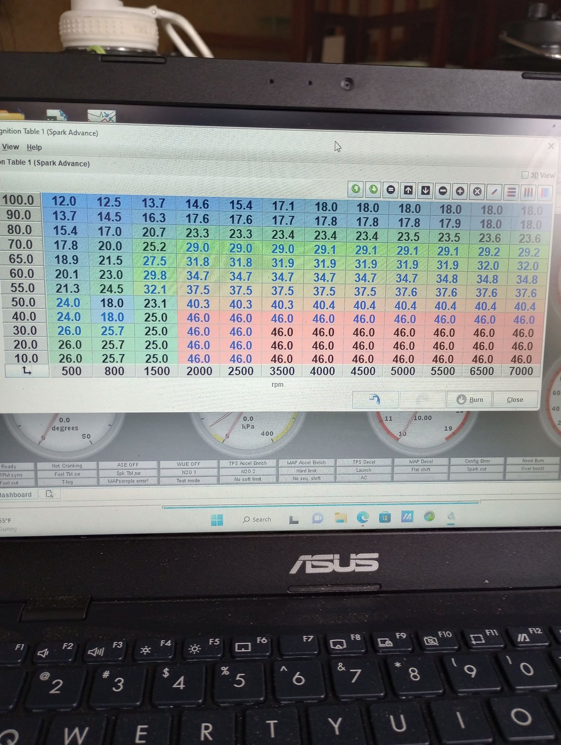

i have an ls truck engine NA and im using tuner studio
does anyone here could share a spark advance table
and or guide me how much spark advance these engine like to ba at idle and WOT and between

There will be several factors that are going to contribute to what it likes. Generally speaking, at idle, I start at 20*. You can probably drop it down but 20* for me is a very easy starting point to get a solid idle.
Up top, depending on compression, camshaft, and multiple other things, you'll probably land 25-27*, but start lower, work your way up reading plugs, watching AFR, and make changes as needed.

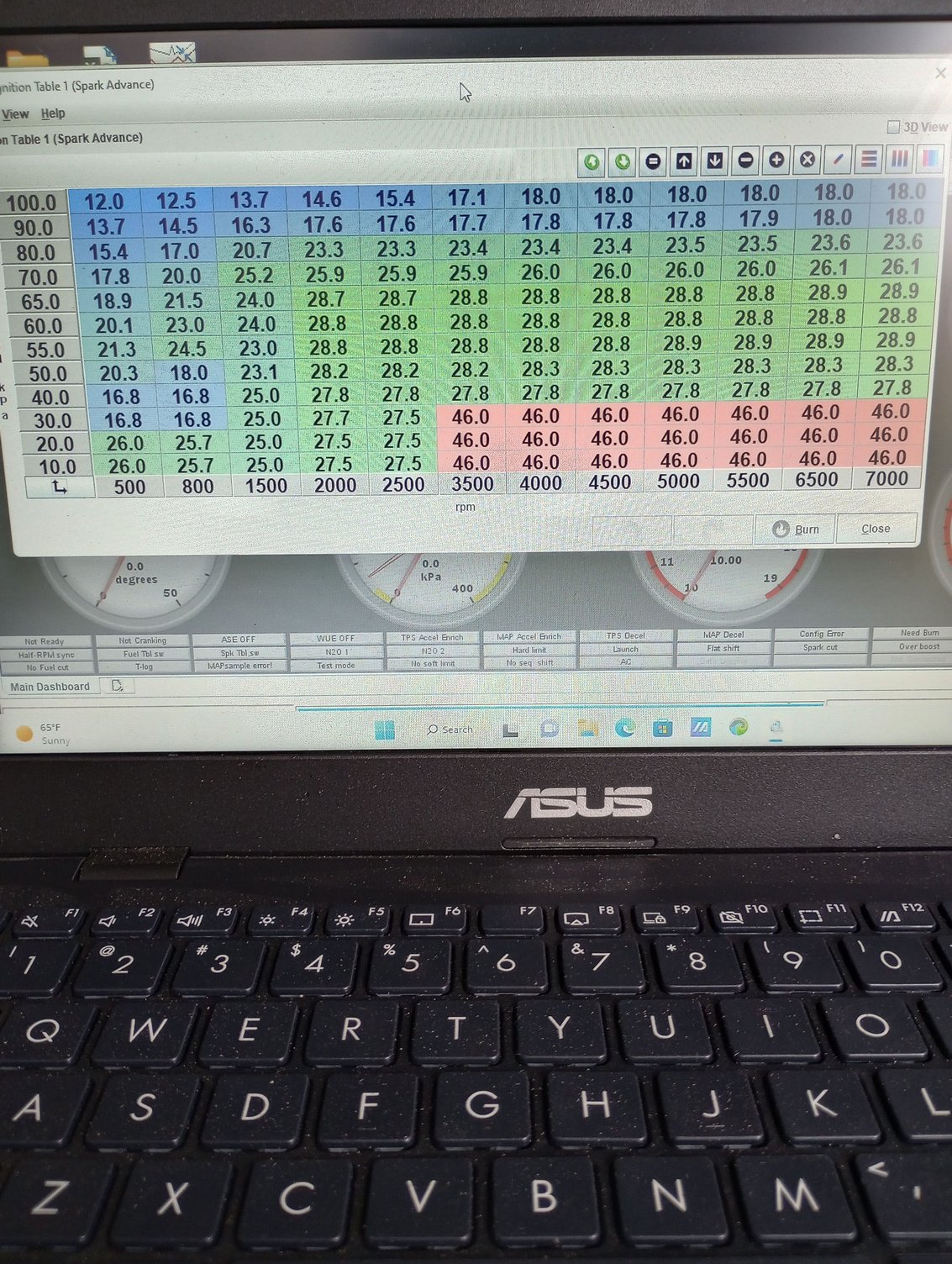

i have a basic factory engine , factory cam , factory exhaust , good compression ( used engine ) , no upgrade yet. because id like to figured out the basic before going crazy
im posting here 2 spark advance table here , that i go back and forth and play with
one has less timing at idle
does the one with more timing at idle look better to you ?
