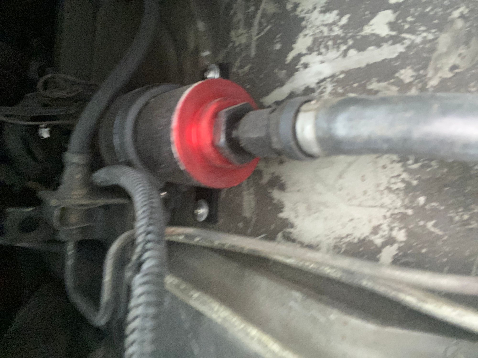

P01 ls1 cam ported 853 heads headers, 3inch y pipe through borla exhaust. I checked for leaks and nothing was found. Could a clogged fuel filter cause this mine is custom from mechanic and reusable.

"Could a clogged fuel filter cause this mine is custom from mechanic and reusable".
Pull it off and take a look..
Have you checked fuel psi?

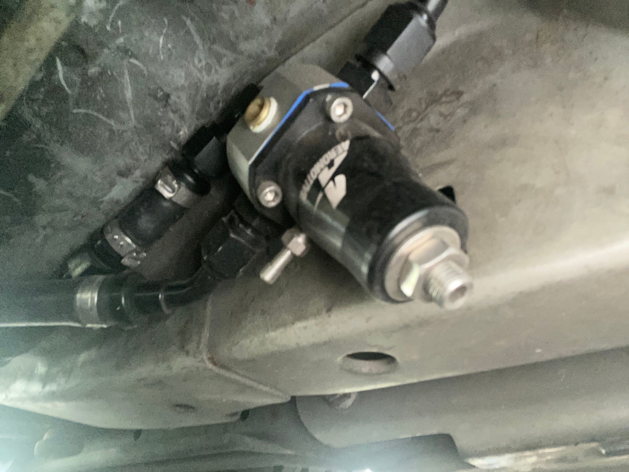

Correct wb going 1.23 Iean. I have an upgraded racetronics pump with reusable cartridge filter and an upgraded regulator outside the tank. It’s all a year old. My guess is the filter needs to be cleaned out. I’m going to pull the filter and clean it with carb cleaner, add seafoam and put new plugs in it to see what it does. If still the same issue my guess us an exhaust leak I can’t see and I will have my mechanic smoke test it.

Question. I have a fuel pressure Guage but can’t find a write up any where on how to remove the shrader valve and install it without damaging it. Any ideas?

The schrader will come right out with a core stem removal tool, should be able to get one at any hardware store or auto parts store. The fitting on the fuel rail is an AN fitting, and I used an AN to NPT adapter for my fuel pressure gauge sender.

You shouldn't have to remove the valve to check the fuel pressure.
Most, if not all, fuel pressure gauge hoses have a small metal pin that depresses the schrader valve when you screw it on.
Now if you have made something that screws onto the test port that doesn't have the metal pin, then yes you would have to remove the schrader valve.
