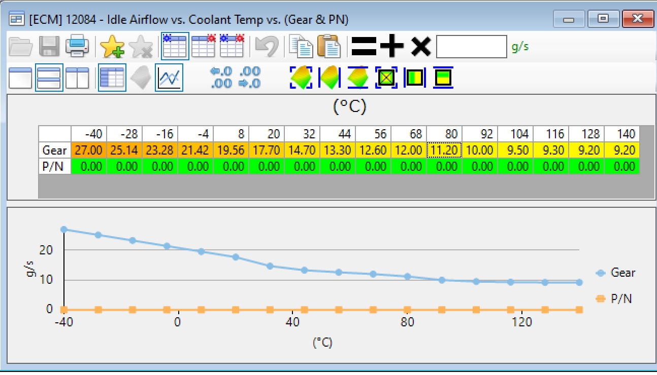

Old Apr 27, 2023 | 04:02 PM
v1.5's Avatar
Joined: Apr 2023
Posts: 15
From: Palo Alto, CA
In my 05 cts-v with a medium cam (227/235 110+3) with DBW. It's not perfect but it's pretty close.
here's my RAF table.
Old Apr 27, 2023 | 04:07 PM
Gav's Avatar
Gav
Joined: Jul 2012
Posts: 341
Likes: 12
From: UK
Brilliant thanks, will try some higher numbers.
regards
gav

Old Apr 28, 2023 | 02:56 PM
Gav's Avatar
Gav
Joined: Jul 2012
Posts: 341
Likes: 12
From: UK
Upped the g/s by 2 ish and now can drive it ok as it's warming up. In fact revs hanging a bit now and reluctance to drop to my target 950 at normal temp. Will try decreasing cells at operating temp a bit.
