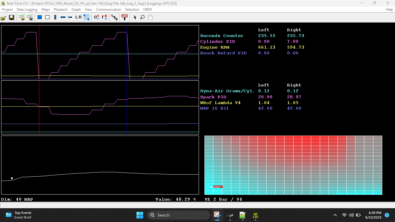

I don't post on here often, but this is something that needs more attention in the US. I mostly hang out on the pcm hacking forums and have recently been working with a Australian guy named Richard. Richard and his son 20 years ago developed a daughter board for P01 and P59 pcms that allows tuning in real time (similar to the road runner, but way faster) and with built in data logging capability over a rj45 Ethernet cable.
As most of you know when data logging you can only see so much.. Maybe getting 15 pids at 20 hz? Well with the real time you can log as many as you want at 160 hz! That's 160 samples a second for EVERY single PID or direct ram offset you can imagine. Yes it logs any Ram Offset you can think of. Your also not reliant on some 'company' to allow you to modify a table. You can add and modify EVERY table etc within the pcm in real time with it running.
This is just a quick screen shot from idling in the driveway. Note the Second Counter and the Cylinder Counter. The red line is on first cyl count and blue is on 8 cyl count .You will never see each individual cylinder with anything else. You can actually pinpoint the exact cylinder that is knocking or whatever you need. It also tracks within the table you're modifying so you know where to edit.

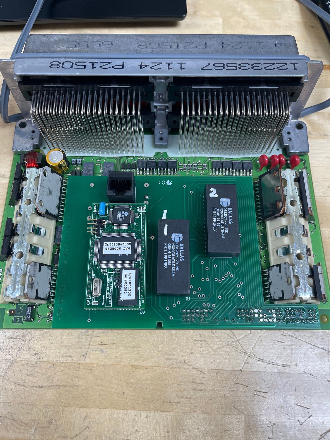

This is the daughter board installed.

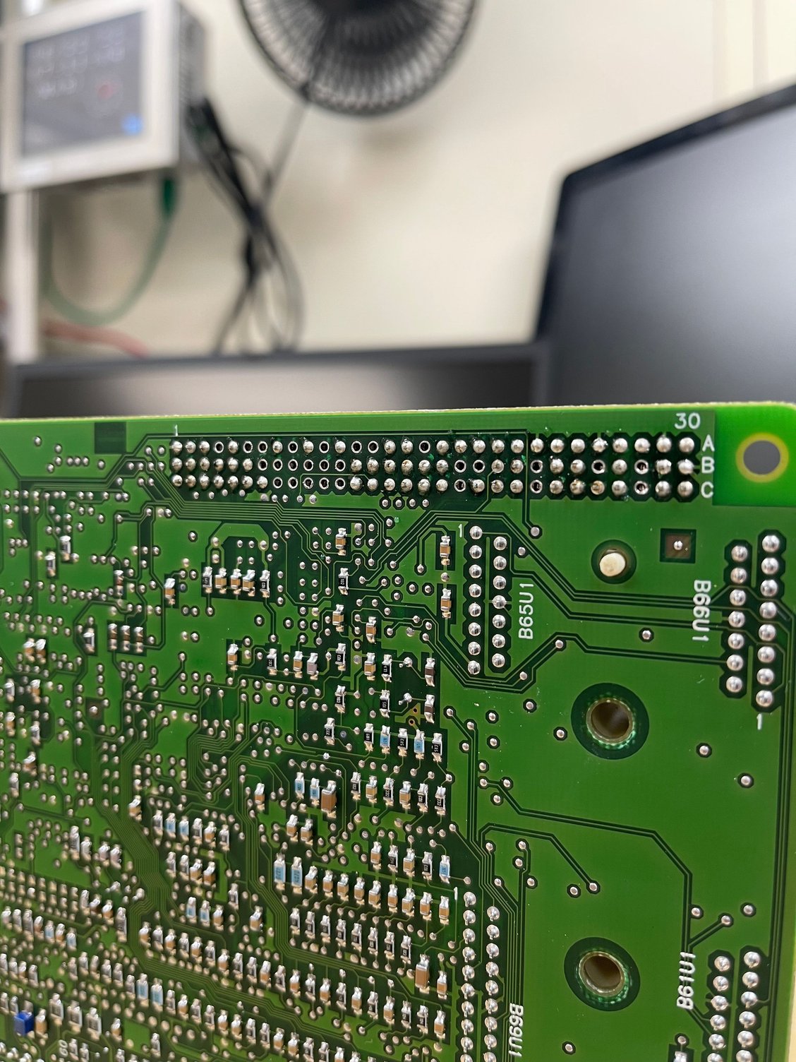

These 3 rows of solder pads must have the solder removed to install the real times header pins. All are not necessary, only where there are pins on the daughter board.
Another shot of header pads.
Hole cut in case for RJ45 Ethernet cable. Used for real time updates and logging.
There are a couple other eternal mods that must be done to the case, but are very minor. Also the flash chip must be completely removed. Hot air rework station is recommended.
