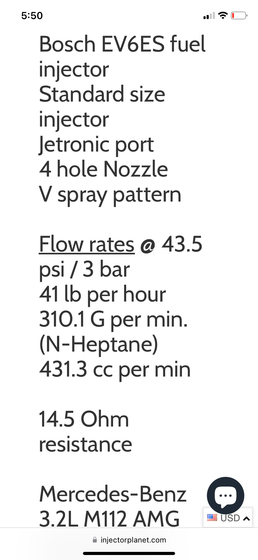

Thanks for the reply. This is the info I have on the injectors, I can’t use this Information in some of the calculators out there to figure out a starting point?

I just used an Injector Calculator: https://www.witchhunter.com/injectorcalc1.php
310grams/minute is 29.5 Lb/hour.
Since that is the 3Bar rating and LS engines typically run at 4Bar, that pressure increases gives you 34.1 Lb/Hour.
It is good to have all the other specs too as there is a delay depending upon voltage.

310 grams a minute is 41lbs per hour.
bumped up to 4 bar is 52 psi. I changed my injectors accordingly. Started on the second crank and idles on its own great. Now I can start dailing fine tuning the rest. Thanks everyone

I know how you calculated that, but they don't agree with any injector site. Since you didn't like/trust the injector calculator site I mentioned before, here is the one from one of the most reputable injector suppliers:
https://deatschwerks.com/pages/other-conversions
310 g/minute is 30 lb/hour (Yes, 310 divided by 454 times 60 is 40, but that is not how any injector supplier calculates it; there must be more to it.)
And the increase from 43.5 psi to 58 psi, is not to multiple by the difference (1.33 or your 1.27) but rather by its square root of 1.15.

the calculator you keep sending does not have g/minute it has cc. I’ve found g/minute conversions and it comes to 41.5. Put in the cc calculator and it’s 41.5.

Well that explains it and shows my embarrassing mistake.
Your injector specs are in Grams/Minute instead of the more usual (in the US anyway) CC/minute. With water it would make no difference as 1 CC of water weighs almost exactly 1 Gram, But gasoline (N-Heptane) weighs less and therefore 1 Gram is 1.45-1.49 CC.
Therefore 310 G/Minute is indeed 41 Lbs/Hour.
But the flow at 58 psi is less than you calculated. It is 41 times Square-root(58 divided by 43.5) = 47.3 Lbs/Hour.
