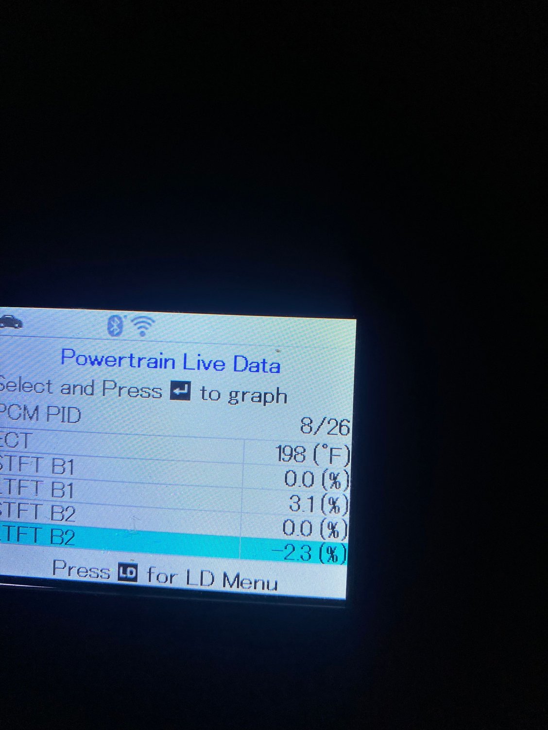

Fuel trims at idle are attached

Upon trying to accelerate fuel trims go positive adding fuel for bank 1 STFT or LTFT up to 25% and bank 2 goes -10 or so until I get off throttle so ECU is trying to add fuel and take away depending on bank, swapped 02 sensors left to right and stays the same

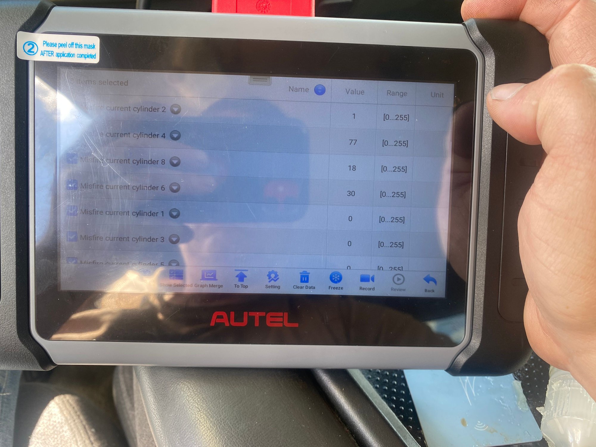

borrowed a much batter scan tool.
Ran fuel injector pulse test
1-8 all identical.
ran misfire data and it’s missing on 2,4,6,8. Picture attached. Gonna swap coil packs to driver side and see if it follows

Narrowed it down cylinder 4 with massive misfire and 2 minimal, Swapped plug, same.
moved coil and wire all to a cylinder with zeros. Same same, pulled valve cover and rockers are still torqued, no broken springs, rockers all move perfectly while cranking, took for a drive and doesn’t pop code immediately anymore or at all at this point.
Found slightest exhaust leak on manifold on cylinder 4/6 going to swap in a new gasket just in case then an injector. I’m sure I’ll report back.
