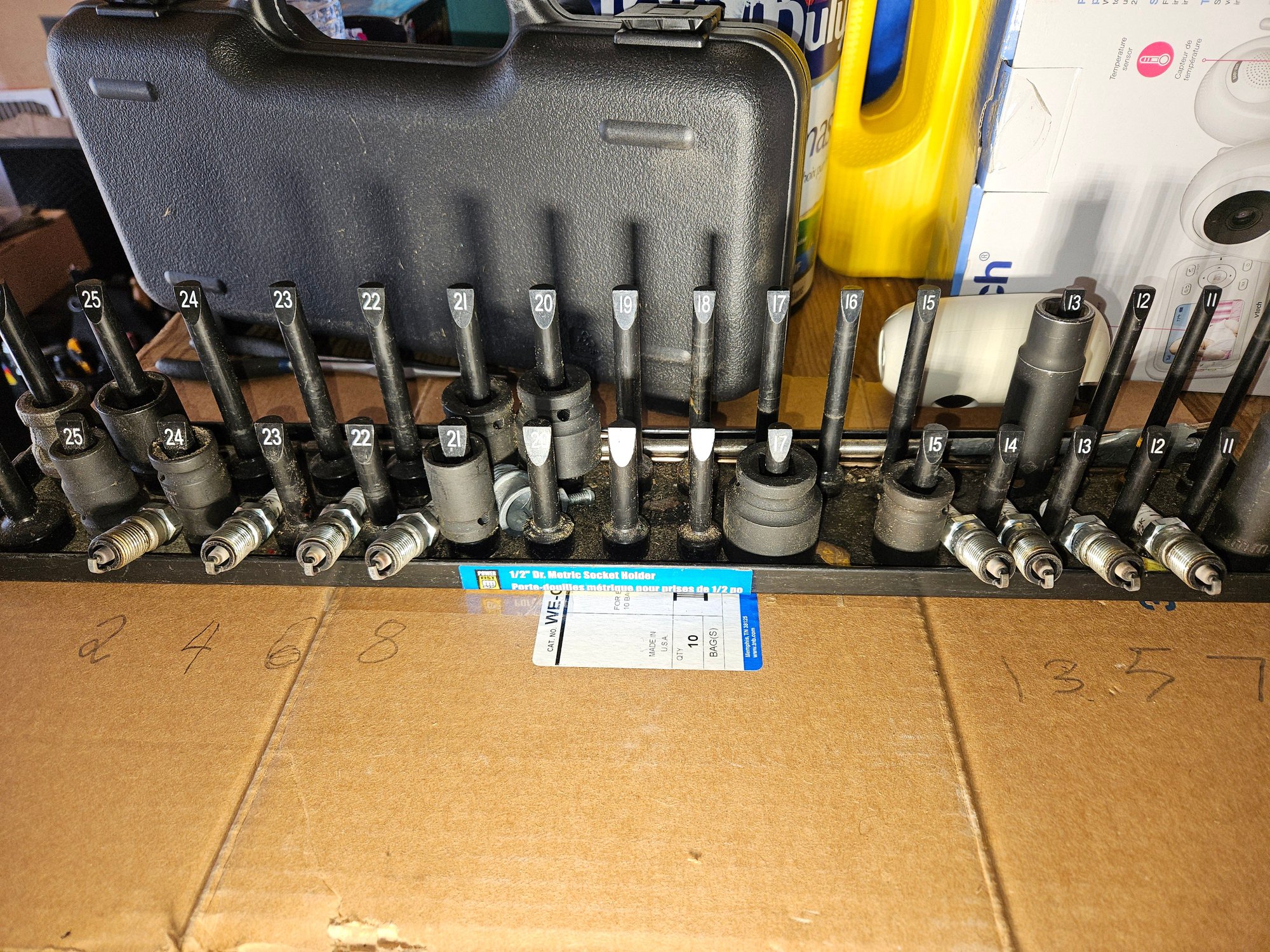

Here are spark plugs. Do they look rich? Exhaust smells rich.
So I will conclude injectors are not the problem.
-fuel pressure is good
-any pointers on how to check the maf? Car was tuned 10yrs ago by a well known pro. I haven't modded anything since besides gears.
-do you guys think the tuner can detect a sensor is out of which by looking at his data logger now and comparing it to the tune on file?
I appreciate all the help fellas
