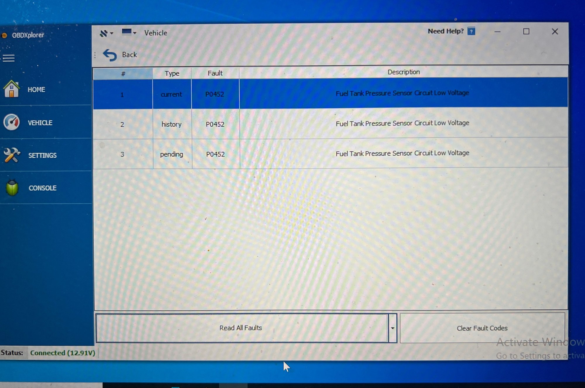

  • P0452 Fuel Tank Pressure Sensor Circuit Low Voltage (removed DTC from ecm not needed for vented aftermarket fuel tank)

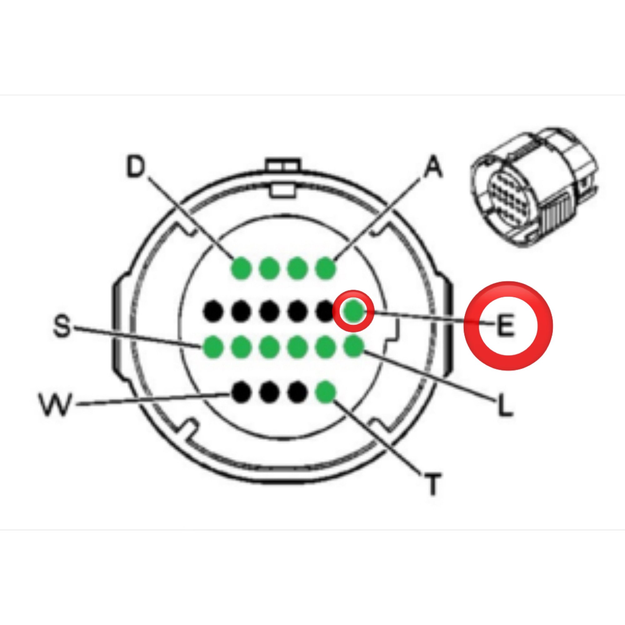

(The final 5 codes on the list were all caused by poor continuity on the pink 12v wire that runs to the transmission on pin E.)

The fuel tank pressure is used to drive the EVAP purge system, so that one may not matter if you have a vented fuel tank. The rest of those indicate serious issues that must be diagnosed and fixed.

@gametech thank you for the help. I am indeed running a vented fuel tank. Hopefully someone can chime in and let me know how to shut that code off in the actual tune file.

Stayed up to 3am working on it and got rid of all my transmission codes. Turned out to be the 12v pin E on the harness having poor continuity. Replaced wire and tested the ground to make sure it was properly grounded. Success no more codes.
in case anyone has this issue pin E On the harness can be tested to make sure it has between 11v or 12v use the ground off the transmission harness to mimic the actual power that the transmission is receiving.
also when installing the connector make sure the side with the arrow is facing outward.

all that’s left is to do is turn off the code for the Fuel tank pressure sensor and reflash the ECU. Time for a well deserved ice cold beer 🍺
