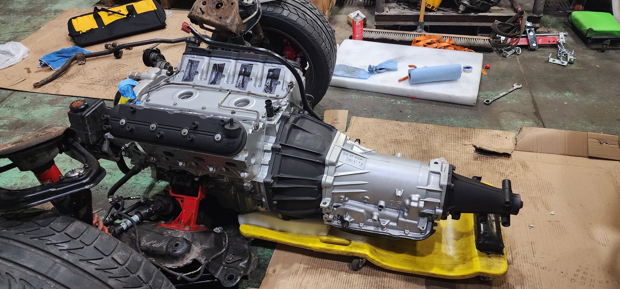

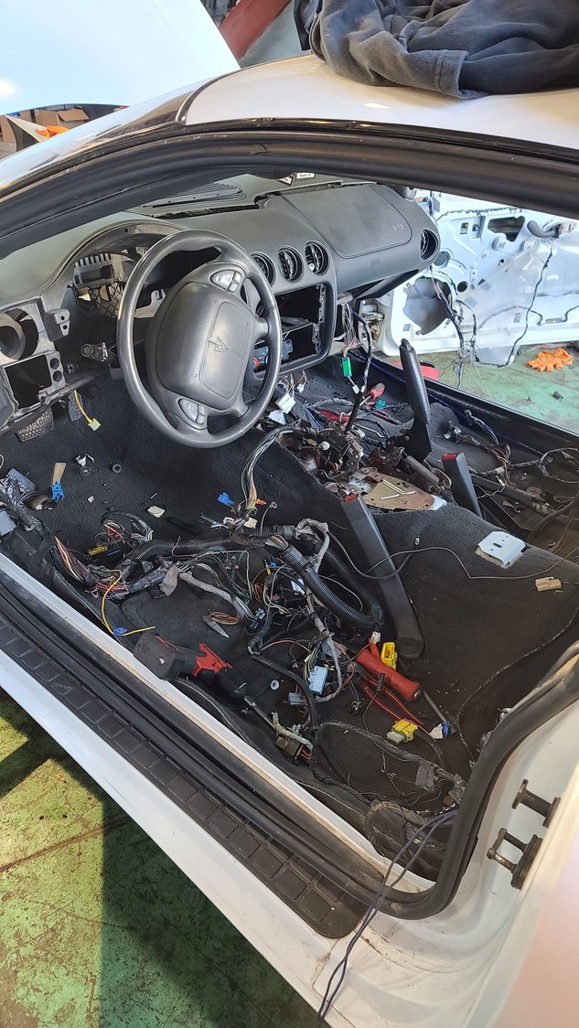

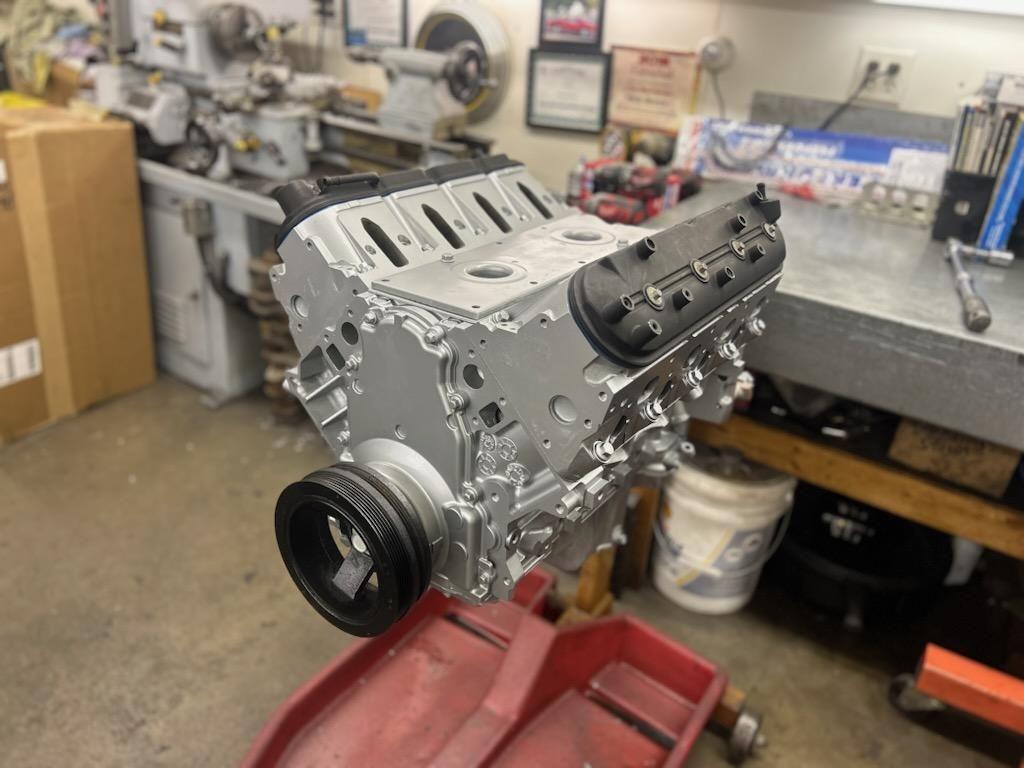

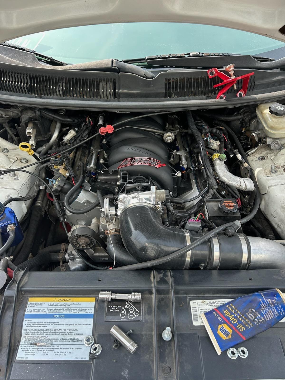

Short back ground 96 firebird 6cyl complete ls1 swap body harness engine harness all wiring from donor 99 trans am motor tore down hot tanked ballanced all new every thing 243 heads completely gutted new springs trunion brass upgrade fast 92 intake nick williams throttle body no reused parts on motor all new upgraded transmission performabuilt level 3 4l60e circle d converter on and on when tuning everything went perfect except ecu is not commanding shift at wot . The ecu was not from origunal donor car so had to find another which was from a manual car is it possible there is missing data on ecu being that is was for a manual car ? Any help would be greatly appreciated . Before the usual chime ins all grounds have been checked over and over all grounds cleaned and properly attached when i say all i dont just mean engine harness grounds i mean body harness ect thank u in advance .
