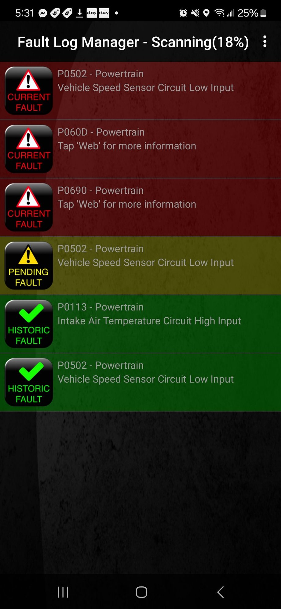

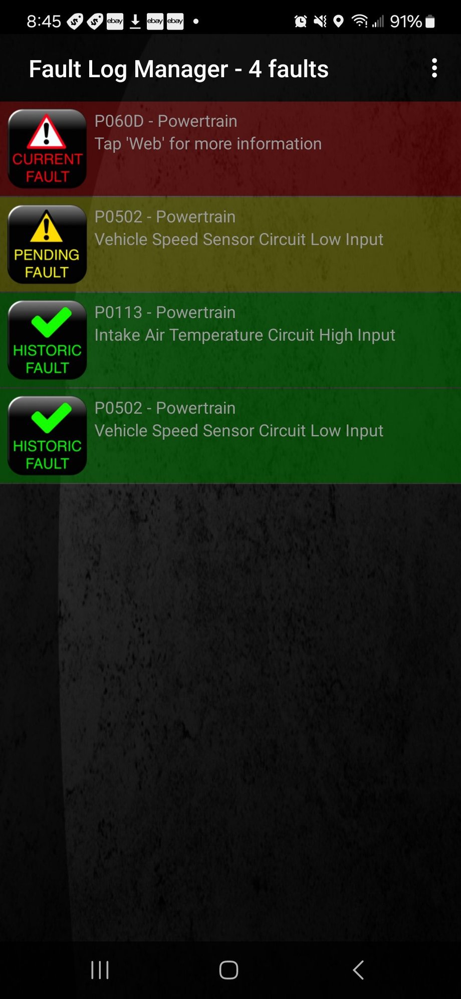

Ok just got back on here havnt had a chance to mess with truck til today and get back look back into this. Ill get verified part numbers for you. Goin to get the tuner to tell me what the motor came out of. And see if i can get part number off thrttole body. I appreciate this. Here's what I did today on a long test drive. I ended up throwing the a p0690 code, so I went back out to do multiple test hits. I only got it to throw the the p0690 code 1 other time. It was the first time along with the p060d code. After that I did another 4 passes and got it to throw the p060d code but NEVER got it to throw the p0690 code again. Then drove home slow and casual with no problems. Seems to be problem when reving continuously over 3500 rpms. Also noticed the ignition relay on fuse block gets pretty warm. I can hold my finger on it. But I could almost say it's hot. Also I've never had the speed spensor code come up as a current fault in red. It's usually pending. And never was red or current etheir again after the po690 code never came back. Also to the p0113 code always shows up as a historical fault? Not sure why. And speed sensor wasn't used during intial tune, but later turned it on trying to fix the p060d code which didn't work and had no effect on the p060d code. The new harness won't reach the snesor and goin tonorder an extension.
