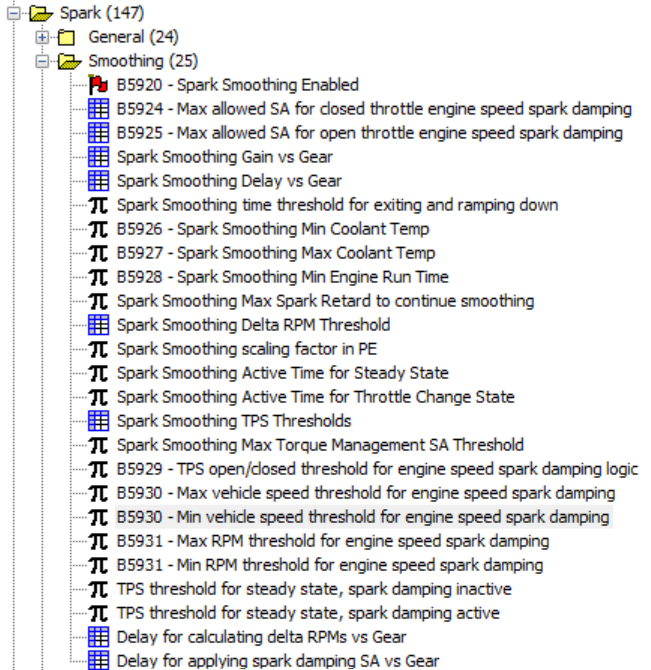

I just noticed the tables for "RPM derivative speed control" aka RDSC aka "spark smoothing" (at least I think spark smoothing is the same thing?) and apparently it retards spark when the engine speed is increasing and advances when engine speed is decreasing... so that got me wondering if it would be useful for slowing down or reducing the strength of low-RPM/low-throttle cam surge.

You mean this table?

Sort of... There are also a bunch of options to configure how much smoothing to apply, and in what conditions. This is in Tuner Pro:

I have not tried the additional parameters in tunerpro, but it has been my experience that just turning on spark smoothing in hptuners does nothing good. Those other tables could make a big difference.

PCM Hammer + Tuner Pro might be a better option than EFI Live, that's where I got that screenshot.
The only catch is that there's a lot that varies by operating system. I'm using 12587603, which has more tables defined than most.

There are some tables that are based on RPM, MPH, and gear, but I don't see anything based on the clutch switch.
If anyone wants to see the nuts and bolts you can grab a copy of Tuner Pro, and get the "mother of all 7603 XDF files" xdf from pcmhacking dot net (IIRC we're not supposed to link directly to other forums) and look at the attached stock 2004 Corvette .bin file.

On the Gen3 PCMs I only see spark smoothing trigger on a fast throttle transition like a quick shift near the limiter on the manual trans cars, it will pull timing and put it back in and can make for what feels like a lazy throttle response. I've never seen it trigger or do anything at all under normal conditions on these PCMs which also means it's not going to do anything for cam surge.
