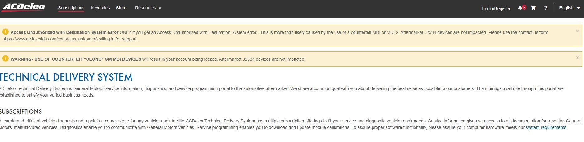

You will need an AC Delco TDS account. I think your cloned tech 2 will work. GM cracked down end of 2024 on the cloned MDI's and cloned hardware. GM will block your account if you use a cloned device. All the clones apparently use the same serial number so its easy foe them to block. A lot of options can just be turned off or on but some require programming. The GM programming is VIN based so if it doesnt give you an option to turn on AC seats its not going to be as easy as just re-programming the BCM.

They will block your account with a clone. You may get lucky once or twice. I personally know several people who it has happened to already. Its also been brought up a ton online about it.
I wouldn't be surprised but I just used it a couple weeks ago to flash a new pcm for a customers malibu
