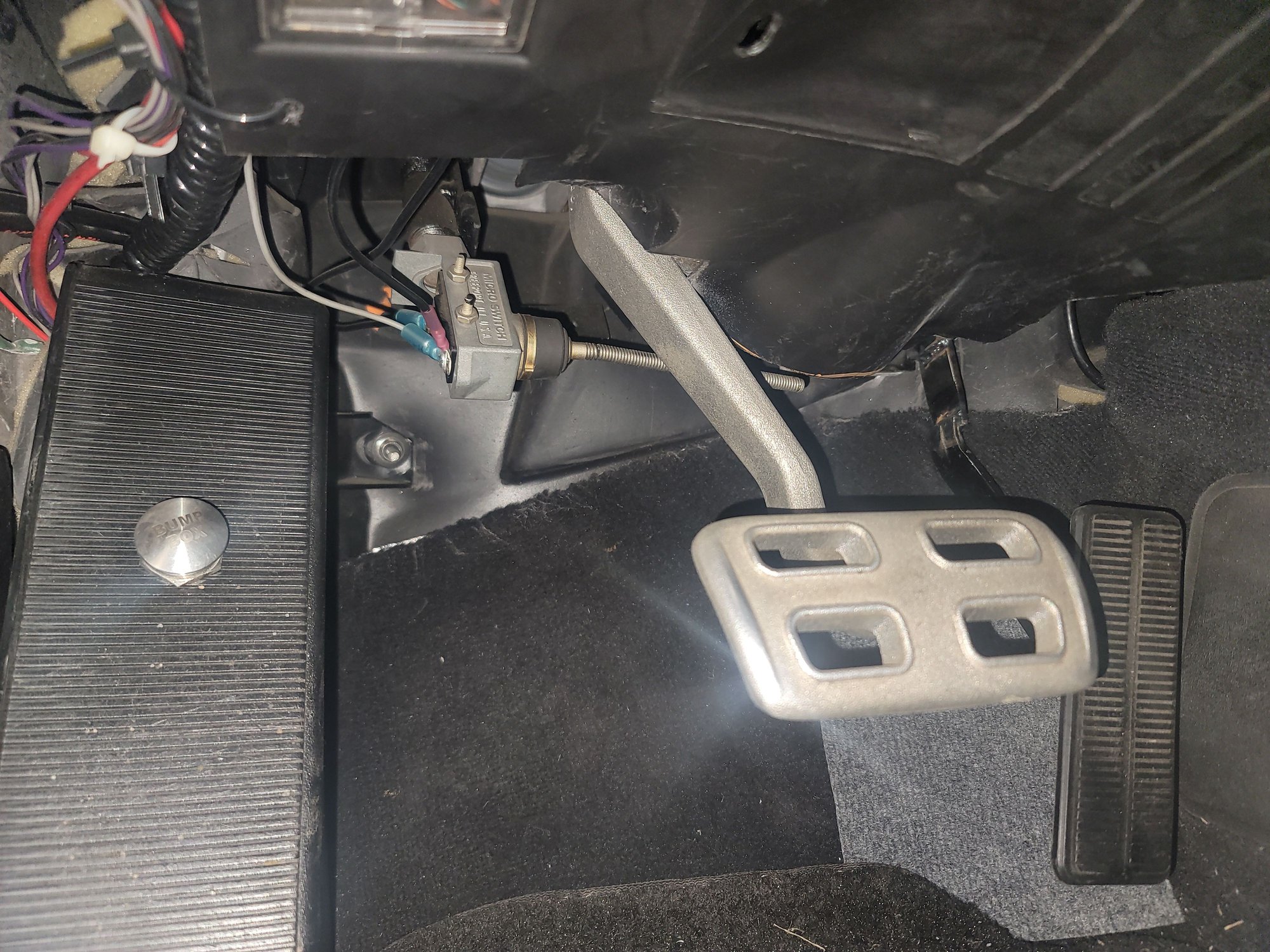

I have this spring so when I push on the brake it activates the 2-step,You have to make a bracket And I made it adjustable,I know it's not a clutch pedal....but

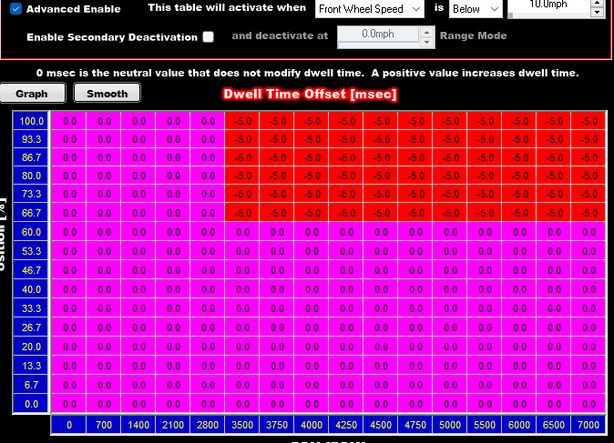

Old Apr 1, 2025 | 07:08 PM
LS1Formulation's Avatar
Posts: 3,894
Likes: 1,139
From: Grand Rapids, Michigan
So this is what I set up, and it works well as a 2-step but it's not building any boost:
Do I need something else to build boost? Or do I have this configured wrong?

Why dwell time?

Old Apr 1, 2025 | 08:26 PM
Posts: 3,894
Likes: 1,139
Originally Posted by Bbknucks
Why dwell time?
Someone suggested it on the Sloppy Mechanics FB group. And it does work, but it's basically cutting the spark completely off, which isn't going to do much for getting heat into the exhaust. When I tried it, it held the RPM just fine, but I had zero pops and bangs out of the exhaust.

I feel like dwell would be more useful for creating a limiter than manipulating how one behaves...interesting

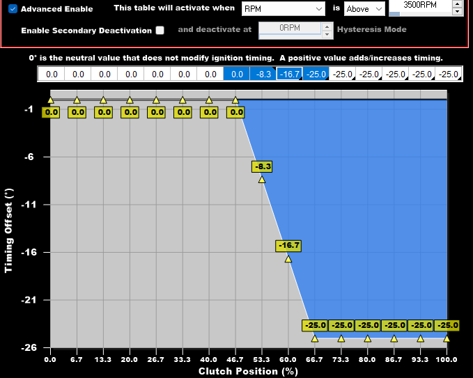

Posts: 3,894
Likes: 1,139
So, I figured out that I can't do a 1D table, because it doesn't take speed into account and and is on all the time. So I built a 2D table instead, but it doesn't work. Even with 60 degrees taken out, it still revs up past 3750. Doesn't sound happy, but it doesn't sound like any 2-Step I've ever heard and doesn't build boost. I will say, the part of the timing map it hits when I'm free revving it is at 38 degrees, so it's only going to -22 degrees. Do I need to take even more timing out?
