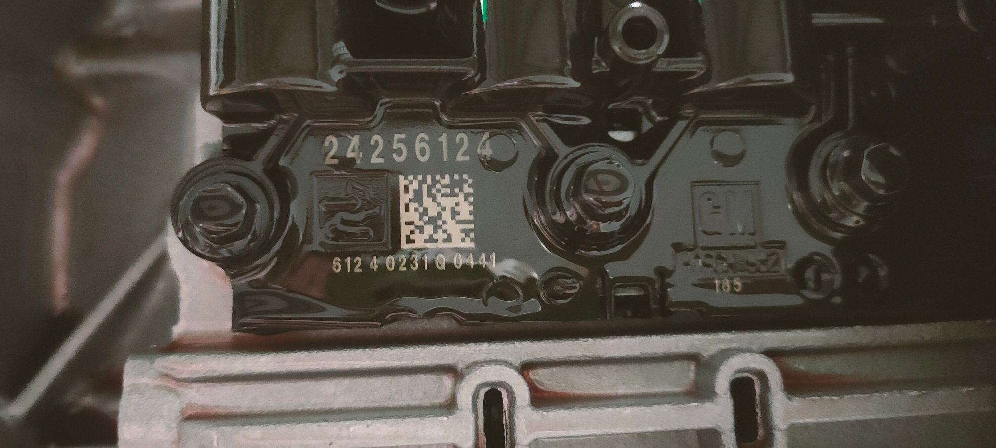

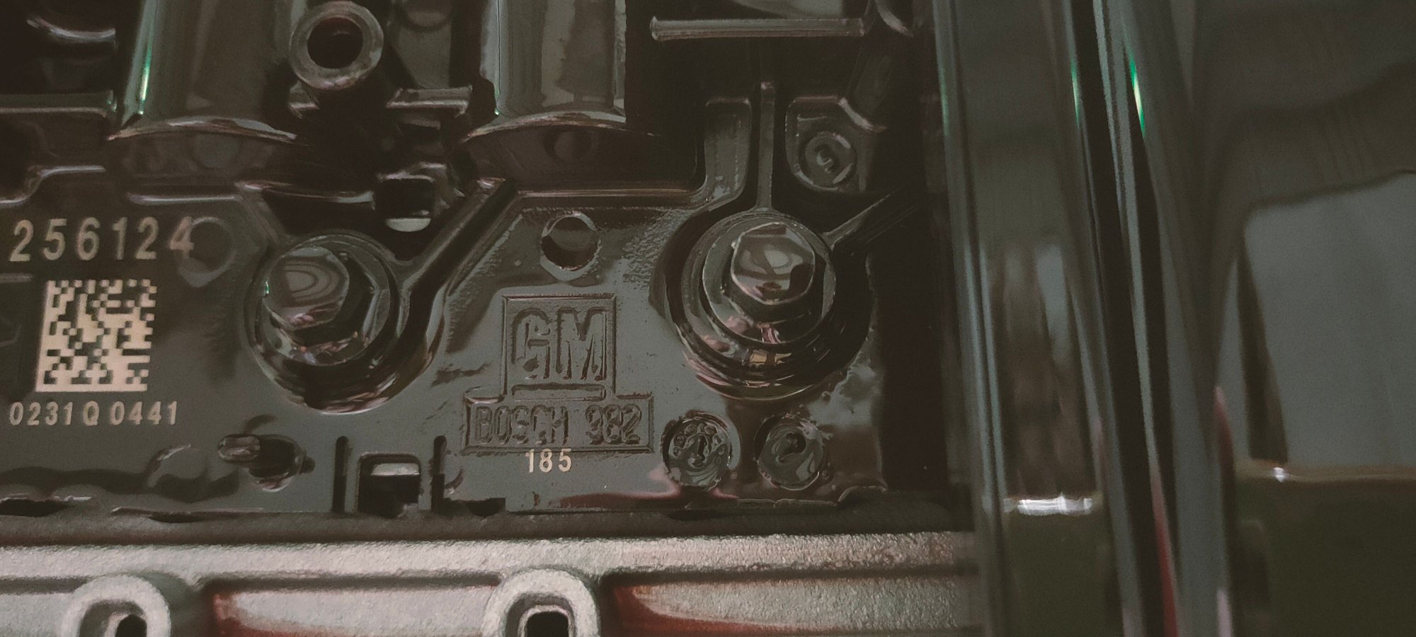

Hey team, I'd really appreciate some insight on whether this E38 PCM I have will be capable of controlling a 6l80 I have purchased when apparently it was originally paired up with a 4l65e not this 6l80.
The E38 service no is 12603892
I think the part number is (large numbers across the top) 12607217.
The TCM on the 6l80 apparently is not original to that transmission but it's numbers are 24256124
If they are compatible I'll splash out and buy the hp tuners kit and try reflash them but I'm completely green to this GM stuff... I'm hoping that it's possible to flash in a tune that will work as it will cost me about $1000 to get HP tuners vs $2800 for the Haltech rebel+ trans controller another $2000.
Any insight would be much appreciated thanks

6l80 TCM
6l80 TCM
6l80 TCM
6l80 TCM
