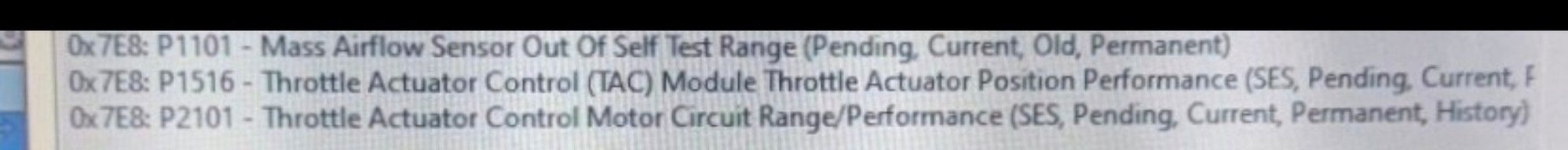

Gen2-LT4's Avatar
Joined: May 2018
Posts: 144
Likes: 9
Here are the codes.
Here are the codes.

Looks like the throttle body is getting sucked shut to me and/or running into diagnostic tests that haven't been set properly. As always without a tune actually being posted, it's just a guess. What throttle body is being used and what computer/OS?

Originally Posted by Gen2-LT4
Here are the codes.
Here are the codes.
post the tune. You’re likely hitting an airlflow limit.
