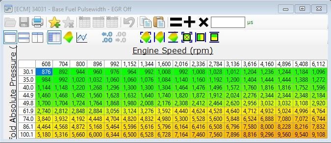

Now these are bad, the older Gen 3 Vipers had a fuel pulsewidth table that you couldn't go above 100 kpa so when scaling things for a 2 BAR map sensor you had half the resolution available in boosted applications. A whopping 5 rows for vacuum and 4 for 15 psi of boost.
