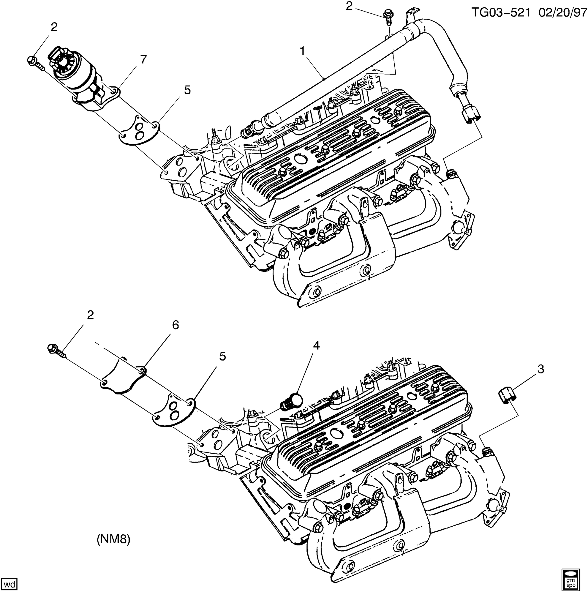

I bet the emissions RPO codes are part of it. If you look at GM calibration database for a single model year of the same vehicle and engine size there are often 10-15 different factory calibrations. I sure some are California, some are Federal, some are Export, some were leaded fuel compatible, etc. That is not even including the vehicles GM built for the federal goverment that often had zero emissions system to them at all. There were a bunch of 350 TBI trucks that were built for the miliary that had the EGR openings in the intake manifold cast shut, no cats, no evap canister, and even lacked an 02 sensor at all, completely open loop and they could run on leaded fuel. A couple of years ago it was documented by someone with a keen eye that Ford was building F350/F450 6.7Ls that were completely factory deleted for the US Military.

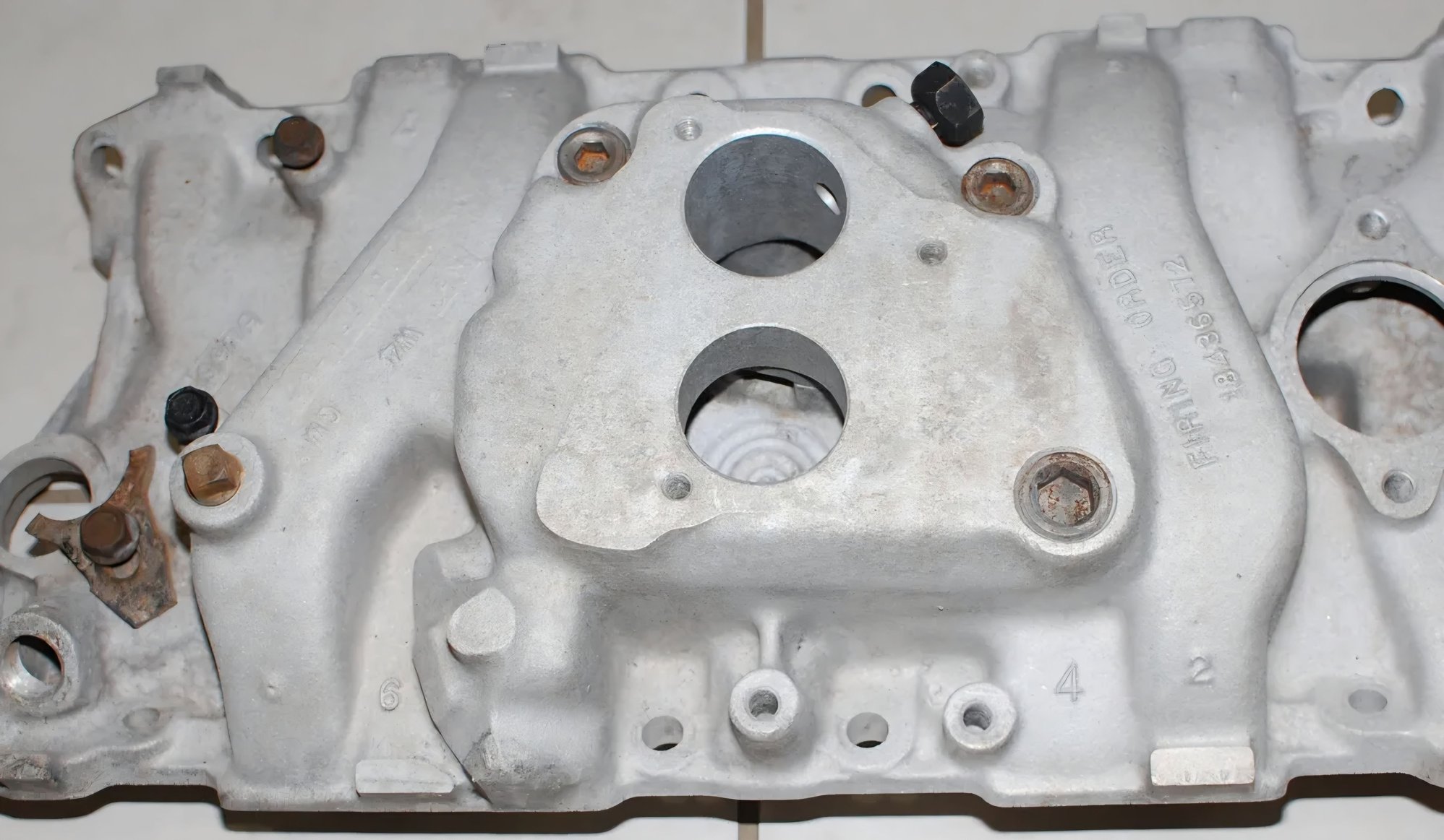

Factory TBI manifold with the EGR opening cast shut.
Also as I mentioned before, you could order the factory GM EGR delete pieces for like $20 for a Vortec straight from a GM dealership parts department up until they discontinued them as well.

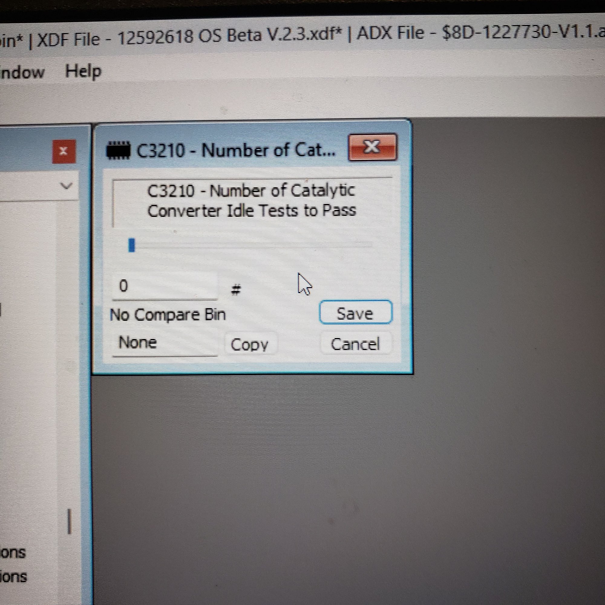

Back to the topic at hand. I stumbled across this in open source. I set it to Zero. Will see if it does anything helpful.

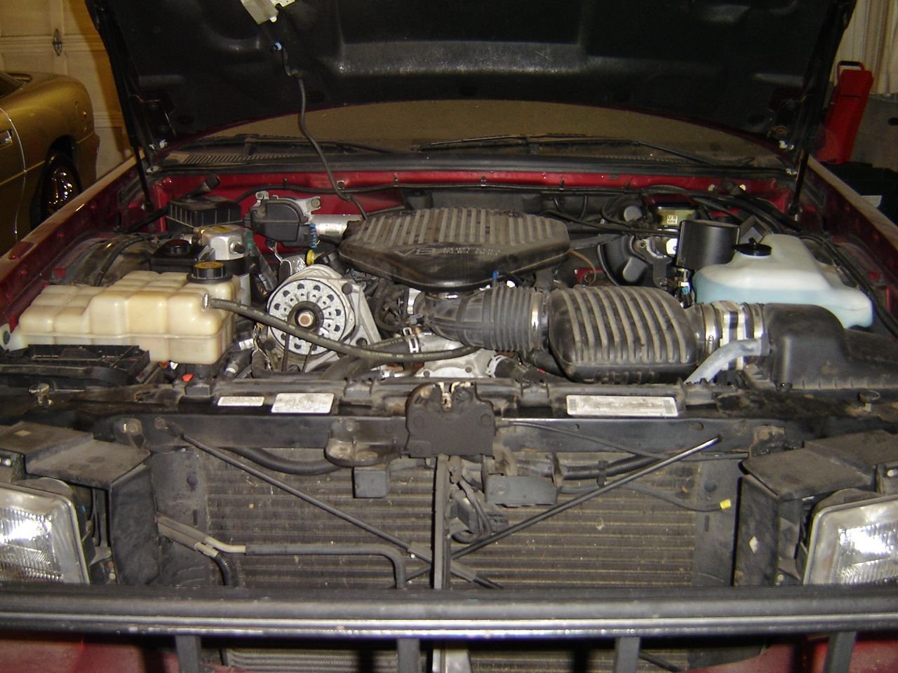

Very cool that your '93 came with that axle and the rear A/C. I wasn't even aware of that package. Mine was a 'normal' Fleetwood but was factory ordered by my Grandfather. It had K4C & KD1 oil coolers as well as V03 (which I think was a higher wattage electric fan, but not the 7-blade clutch fan that was part of the towing package). In this engine bay shot you can see the forward mount cooler:

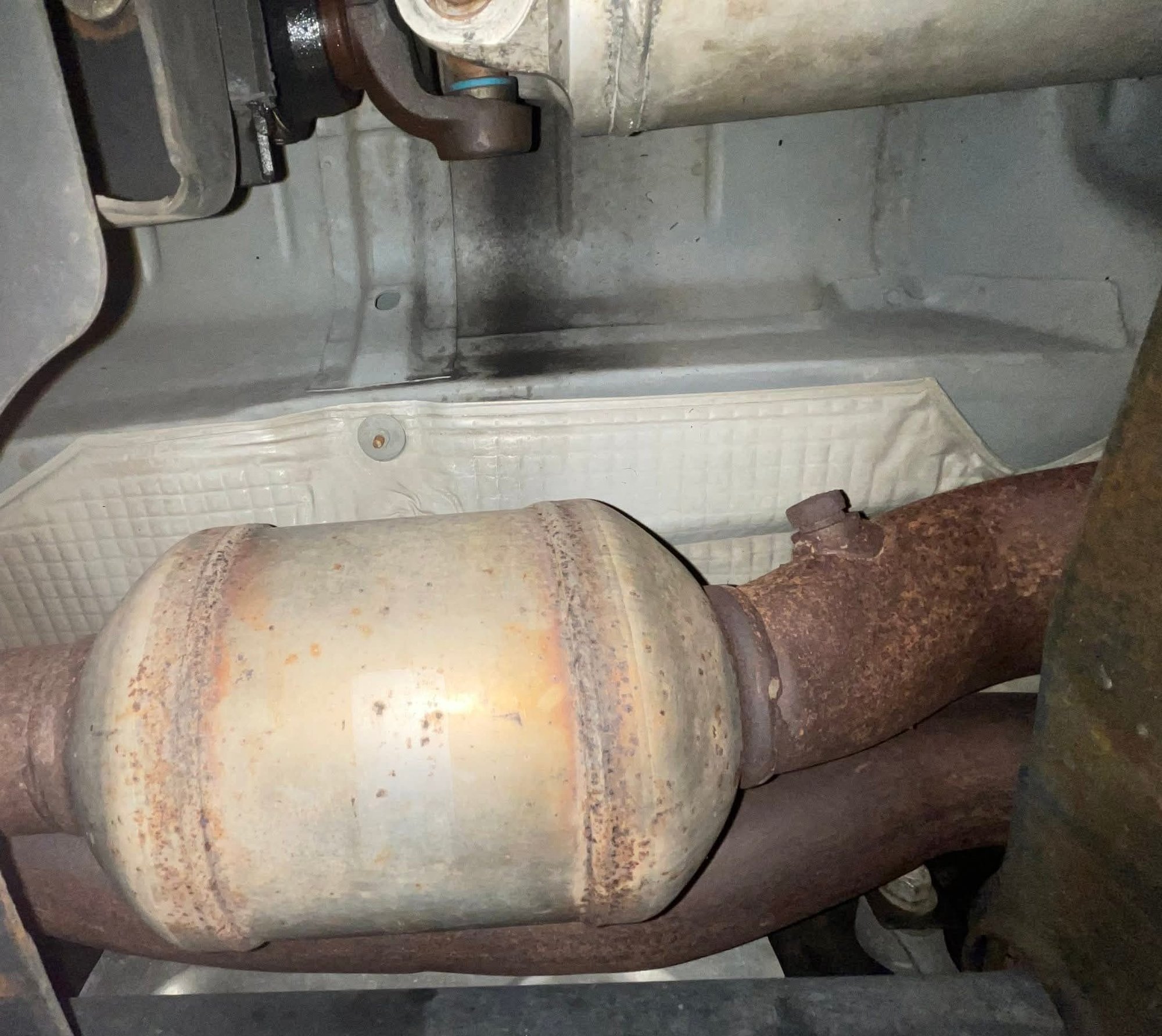

More on that same line we were talking about the other day. 05/2003 production Avalanche. Factory block off plugs and no rear 02s.
I may try another method to get around the prolonged catalyst/rear 02 testing events as it seems it is enabled even in these trucks despite not even having rear 02s. I am thinking of piggybacking the front 02 sensor signal wiring to the rear 02 sensor pins at the PCM. I just do not know if it is going to freak out the PCM having 2 bias voltage sources pinned to the same 02.
For the record setting the Catalyst Test I posted above to 0 did not correct the issue and the issue persists until the 02 monitor test passes after 40-100 miles of driving.
