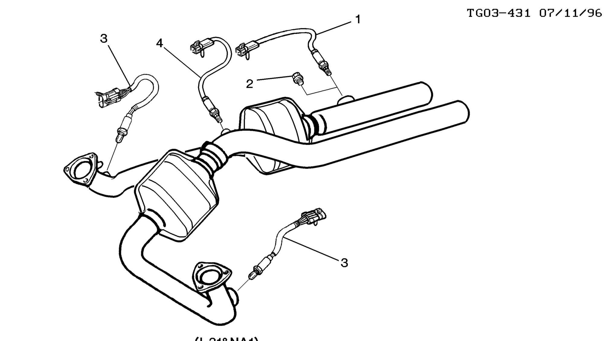

Express van that has been family owned since 1998. No rear 02s as built from GM. Where the rear 02 subharness should attach it has always had a factory plastic block off cap. #2 in the factory parts diagram is the GM factory block off plug that threaded into the 02 bungs where the rear 02s would have resided in a California model. The van never had evaporative emissions pressure monitoring either. With the old black box PCM years ago, the fuel pump o-ring disentigrated and was leaking for who even knows how long at one point before I found it changing the fuel pump.
Some were also built fully open loop, completely lacking 02s and no cats as well. Factory GM parts diagram on a catless, open loop only 2002 model I ran across. I still have a copy of the factory 0411 open loop only tune file from this one as well. This one was a former US Forest Service van.
I am going to try his method as well on mine. See if it makes the P59 stop doing to 02/Catalyst testing. I can watch mine shift the commanded air fuel ratio from 1.00 to 1.1 then to 0.9 during the testing. It will run for about 60-90 seconds, both leaner and richer. I have gotten to where I will not even datalog a P01/P59 until it has about 3-4 drive cycles and 40-50 miles since the PCM was flashed because a lot of the data is rubbish until it has gone through its self testing and learning procedures.

My van that lacked rear 02s was a 1500 L31 with the factory 3" dual to the muffler system. The catless was a 3500 L31 and it was Y to a single to the muffler. I also parted out a 1996 or 1997 K1500 Suburban that still had the factory exhaust and it was also built without rear 02s. This is the stock GMT400 C/K 1500 exhaust diagram. #9 is the same GM 22509274 02 delete plugs that were on that K1500 Suburban I parted out.

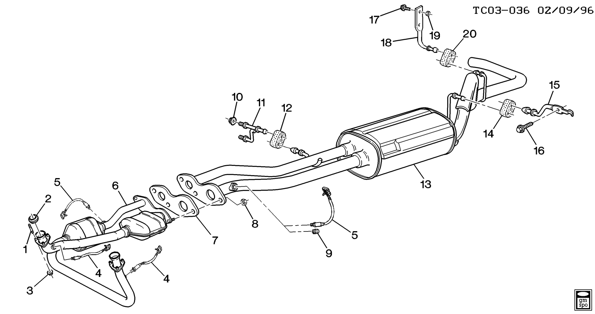

I also added the diagram for the C/K. #9 is 25509274 which is an 18mm plug to delete the 02s on vehicles that did not use OBD2 catalyst monitoring in that time frame. I looked and it had numerous OE applications beyond trucks even. A lot of the 2500HD/3500 6.0L/8.1L GMT800s also never had rear 02s.

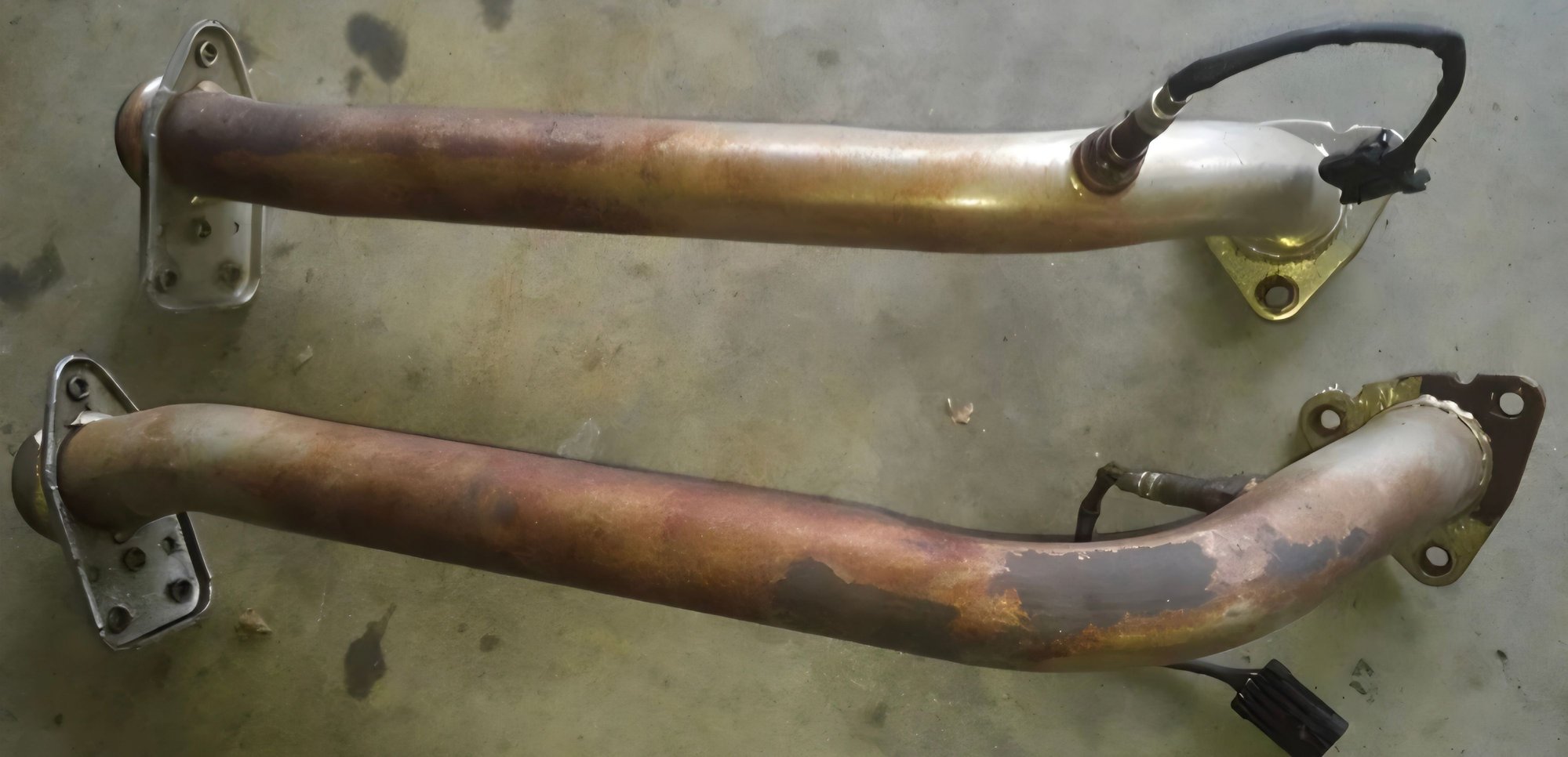

These were factory GM parts on some of the 90s 9C1 Caprices. They had GM and a part number stamped in each side. I want to say were GM 12504014 and 12504015 or something like that. They bolted directly in place of where the cats were on the civilian cars. I saw a bunh of 9C1s with them here in Texas back when all of them were retired and became dirt cheap LT1 V8 powered sedans you could buy for $1,500. I do not recall the 4.3Ls ever having the factory test pipes or dual exhaust so it was an easy way to tell if the car actually had the 5.7L back in the day. A lot of those cars got banged up, put back together and you would have a 5.7L emissions sticker on a 4.3L car and vice versa when the front clips were swapped.
